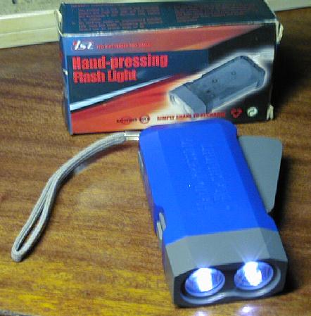

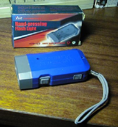

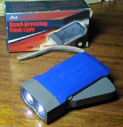

Hi Harvey,
I think I've got a similar one, bought it last year for € 2.
Until now it worked every time I needed it, even without
cranking it up. I started to think there was a miniature
nuclear reactor inside running on nuclear waste. :D
The second switch locks the crank in to the housing so
that it appears to be a "normal" flashlight.

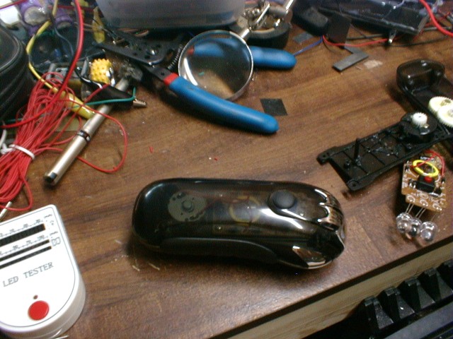

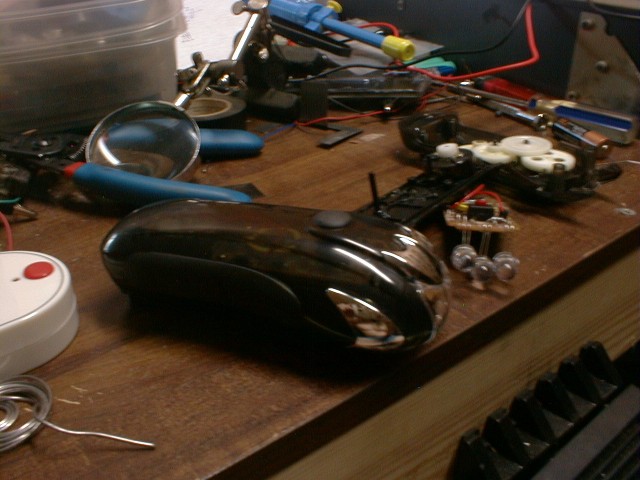

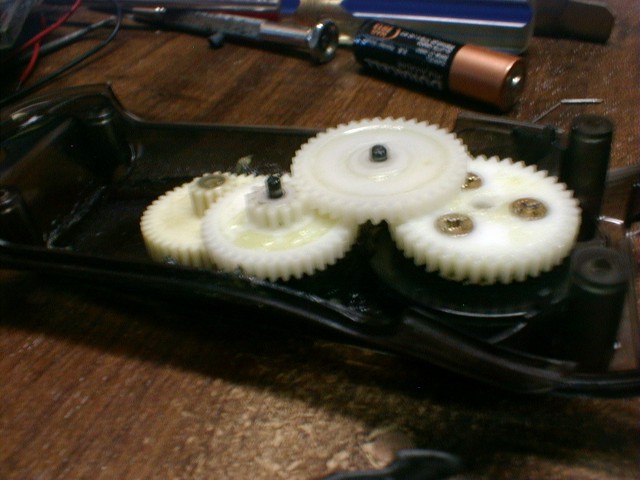

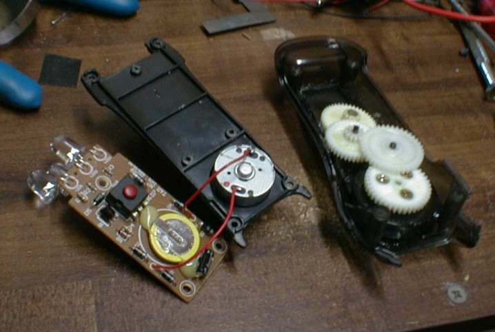

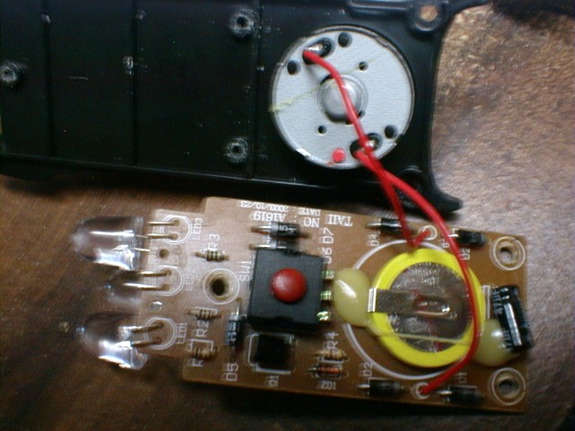

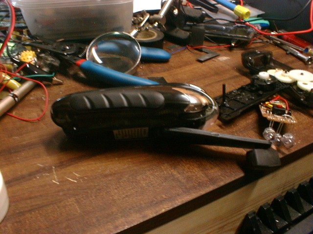

Yeah, I like the 'torch' thing too, medieval(sp?)... Anyway, took some pictures, camera didn't complain too much, think I'm loosing my last 8 meg Smartmedia card, time for a new camera I guess.
The big Leds are narrow angle (12 degree?). Only difference in brightness was focus. Didn't take them outside and see what kind of distance they were good for. They were plenty bright for most uses, got a bigger flashlight for blinding...
The generator is a motor, or could be used as one, guess it both could be used either way regarless of origional intent. The shaft spins really free, even small cheap, no torque motors have a little resistance. At 4.8 volts (just a handy battery pack), it spun at a high RPM. Didn't think to try to see if it would turn the gear train.
Never worked with lithium batteries, so left the 10 ohm resistors alone. Don't think they'd effect the brightness much.
Have to do some thinking on how to convert these to wind power. Going to need a much larger rotor, then what I've been using directly on stepper motors. The gearing isn't too bad, just going to take a good gust of wind to get it started turning. I did order some 12 props last week, while getting some replacement blades for the helicopter. Give it try next week sometime.
