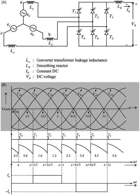

Would this schematic be an accurate representation of the windmill alternator/rectifier assembly if the AC source in the image as the stator windings of the unit?
Yes, ish.
The diagram show thyristors which is why the voltage jumps up each time the phases change. With a simple rectifier the changeover will be as soon as the next phase is larger.
There will not be much inductance in the output if you are charging a battery, but there will be loads of inductance in each winding.
