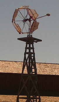

Windmills can be pretty simple. Blades added to a bicycle wheel and a tail fin.
Blade construction varies depending on average wind speed and RPM needed.
100 years ago, dumb farmers, made windmills with tail fins that headed the blades into the wind. At high wind speeds the fin turned the blades away from the wind slightly to slow the speed. At very high wind speeds the blades turned 90 degrees to save the windmill.
