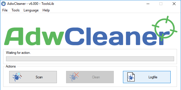

Try these, all have free versions:
ADWCleaner
CCleaner
Spybot search & destroy
Superantispyware
However before installing any of those, open command prompt and use
chkdsk C: /R
That will check for drive corruption, which can cause all sorts of strange problems.
