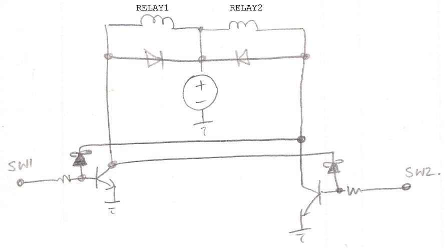

hello forum! i want to wire two relays, in a way, that if the one of two is energized, then it is IMPOSSIBLE, for the other one to get energized..
the catch is, i cant use any of the terminals, appart from the ones that oparate the coil.... anyone has a design that could do that??
thanks!

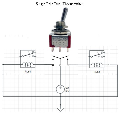

Single Pole Dual Throw switch?
..the catch is, i cant use any of the terminals, appart from the ones that oparate the coil....
thanks!
so you cant wire one coil via other relay? you can use additional relays? or some electronics? whats your working voltage?
the relays are 5v, 2 channel relays. each channel has 3 terminals (input, NO,NC )
on the 2 channels, there will be +16v on one channel, and GND on the other channel.
i can use other relays/elecltronics. the above design uses N-channel FETs. but i am looking for the simpliest possible solution ;)
Using a Single Pole Dual Throw switch, only one or none can be energized.
yes the siwtches will be single pole dual throw. the problem is, there will be 2 switches :D so one can be on one state, and the other one on the other... (the second "Switch" is actually an arduino that also controlls the relays)
Are you saying the Arduino also has a SPDT switch? Or is this switch a port which can be set as an output and can pull high and low?
This may do what you're after. The diodes across the relay coils are to protect the transistors when power to the relay is turned off.
The SW1/SW2 inputs should probably be driven by totem-pole outputs or similar, or the leakage of the schotykey diodes may turn the transistors on slightly.
no, no :p i have a program running on my pc, that has two buttons that you can press ( an SPDT switch). it comunicates via serial with the arduino, and then the arduino sets high or low the pins, in order to energize the relays.
dougy83, yea cool! it seems like it would work !!

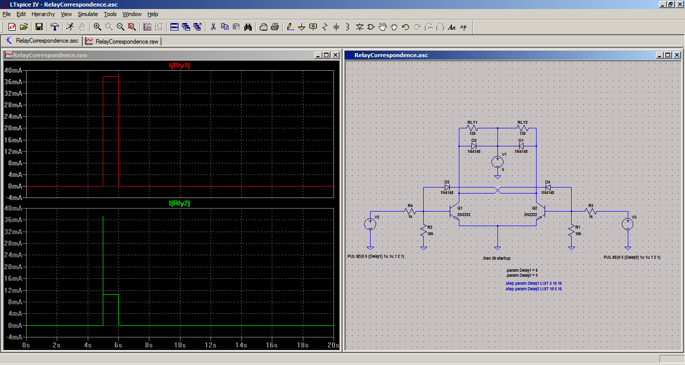

Yes. Just make sure the two diodes at the transistor bases are Schottky types or the circuit won't properly inhibit the OFF relay from turning on. You could use regular diodes if you also add an extra diode directly in series with each transistor base.
Here's a sim..
1 with diode's
1 with schottky's

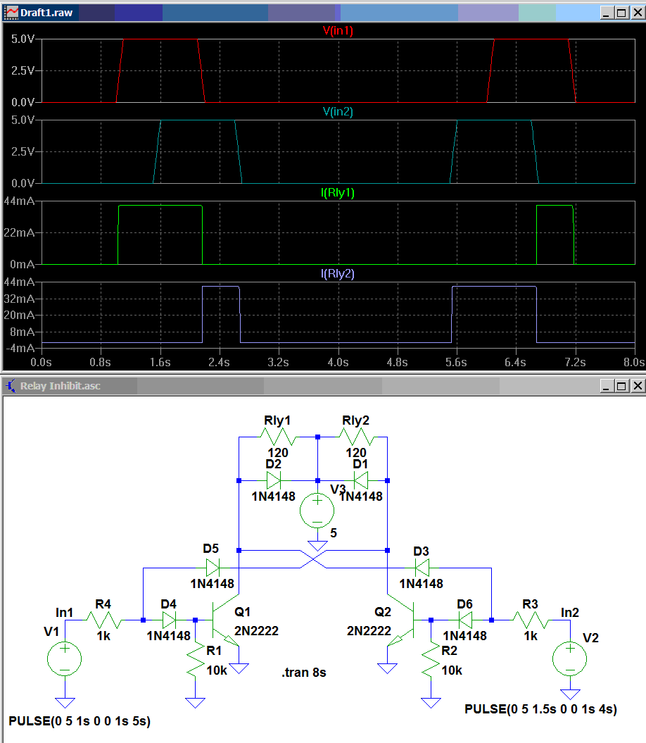

Here's a simulation with an added standard diode on each input (no Schottkys). Note that whichever relay is energized first prevents the other from being energized unit the first one goes off.
Note that this circuit may allow both relays to energize concurrently if both inputs are simultaneous.
