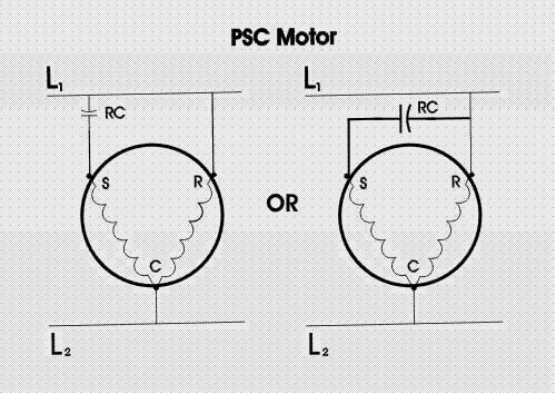

I have attached a drawing of the wires from the motor and capacitor.
I need help with the wire ring of the motor .
I have determined the run winding and the start winding with the resistance of the windings .
Where to connect the 240 v ac wires.
Could you help me with this .
Thank you Greg

The run winding is connected directly across power.
The start winding connects in series with the capacitor, then the two in series across power.
Is it a capacitor start or capacitor run motor? A capacitor start one is supposed to have a switch of some sort that isolates the start winding once the motor is spinning.
A capacitor run one has the start winding and cap permanently in circuit; no switch.

It is most likely a PSC motor, cap permanently connected. i.e. the two wingdings should be identical.
If so you can reverse direction with a simple SPDT switch, with centre off position.
Google PSC motor connection to get a diagram.

Many pump motors aren't made to have the direction changed easily. Do you have a model number or data sheet for the motor? Or post a photo of the wiring diagram that should be attached to the motor.
If it is not a PSC motor, (different resistance reading on each winding pair) then all you need to do is connect as it originally was, but reverse one of the winding pairs.

Something wrong with that DWG, both sides are identical connections??
Here is the SPDT switch version.

I have been successful in doing what I wanted. The start winding has one side of the field connected to the run winding . I have cut the start winding wires being the thin one and attached a insulated wire and run it into the terminal box on the motor . Now I have 2 Ends of the start winding. Swapped the white and black over and connected the black to the white wire and the white wire to the brown wire which goes to the field winding in the motor . I have now reverse.
