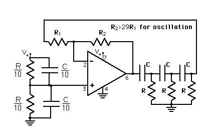

Also for this circuit, is it possible to make a + - power supply like I have with my 2 9 volt batteries with just one battery?
You can run this circuit off a single supply with some simple modifications.

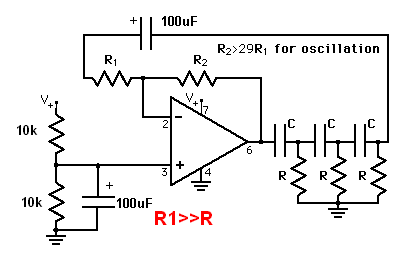

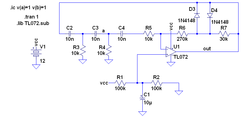

That circuit does not take into account the biasing of the output due to the connection to ground of the rightmost R. Neither takes into account the AC loading of the phase shift network by R1.
Below is a circuit that deals with both these problems, and also has a soft limiting circuit to avoid the waveform clipping that will otherwise occur. Simulation shows 3rd harmonic distortion of ≈-43dB.

If you want to use Hero999's circuit, I would modify it as below.

I just realized that im using all the same resistors for everything. but in the schematics its showing r1 greater than r2 whats the explination of this?

You have it backwards. The schematic shows R2 greater than 29 times R1. I added the note in red, which means R1 should be much greater than R. I would try R=3.3k, R1=33k, R2=1Meg. The first circuit I posted has fewer constraints.

You can use the 1k resistors for R. Use 10k for R1, and 300k for R2. To get around 3400Hz, see the original link:
f=1/(2*pi*R*C*√6)
R*C=1/(2*pi*f*√6)
R*C=1.911*10^-5
If R=1k=1000,
C=19.11nF
You can use either 18nF or 20nF to get close to 3400Hz.
You should change R2 to 330k. In a simulation, it would not run with 300k, but with 330k, and 18nF caps, it gave me 3.5kHz with very low harmonic distortion (-50dB). You might want to use a 270k or 300k resistor in series with a 50k or 100k pot, and crank the pot value down to where it just breaks into oscillation. This will give you the least distortion.
