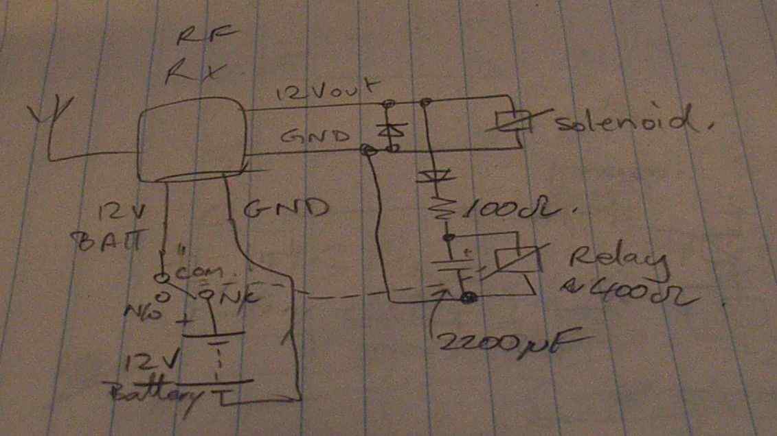

That wireless control thing looks like it has an On function and an Off function - doesn't the OP want a short pulse?
Assuming yes, and assuming that the receiver resets itself if you drop the power to it, you could put a N/C relay contact in series with the battery and power the coil from the receiver output (with a delay). So when the ON button is pressed, the solenoid is powered; after a short delay (governed by the resistor & capacitor & the relay turn on voltage) the power to the receiver is turned off and so is the solenoid; after another short delay (the cap discharging through the relay coil) the power is restored to the receiver (which hopefully has reset itself).

What I was saying is that the buttons on the remote are marked "ON" and "OFF" - so one could assume that the buttons do their labelled function, and don't output a short pulse. So you'd need to push the ON and then push the OFF (with maybe a delay in between if the receiver has blanking built in).
Yeah, we could get cool and if they really want say 200 mSec. come up with a one shot design using a timer like a 555 and so on. I tend to think that considering the OP does not work in electronics or have electronics as a hobby the simple approach is to hack the receiver as mentioned in the OP's link. Tap the button and a short burst of air.
The pic I posted is very simple - it's the receiver the OP mentioned, the solenoid & diode you mentioned & a relay/diode/resistor/capacitor to provide the delays. So it is 'hack the receiver' mentioned + a teeny bit more.
