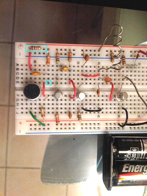

I am having a difficult time understanding why my circuit is not working.
Any help would be GREATLY appreciated!! thank you
I have attached the link to the schematic and images of my circuit...

As explained RF circuits on project boards are prone to problems.
In addition it appears you have at least two wiring errors.
The top left 10K [R1] is shorted out and Q1 base to R2 and C1 is in the wrong hole.??

The thing is, if you want to compensate for the stray capacitance, at least the 33pf might be a variable one. L1 looks ugly, need re-winding for sure.
Look this coil and compare it with yours :)
Lots of wiring errors as like eric already pointed out. Study the breadboard configuration first.
In addition to the problems of the breadboard and the poorly made coil, why are you making the crappy FM transmitter anyway? Its performance is HORRIBLE!
