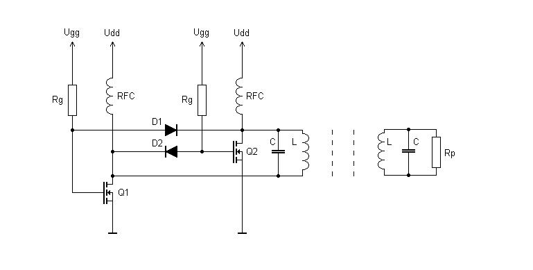

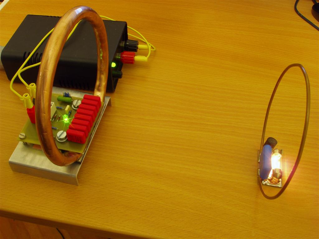

Ok here is a very good link for it with schematics and PCB's designed by Marko Bakula:
4hv.org: Forums / Projects / Miniature wireless power demonstrator
It uses a royer Oscillator as you can see.
I want to know how the royer Oscillator does work there? I guess those 2 RFC's are functions of the parallel LC in the transmitter, right? And I guess the circuit is a some kind of push pull amplifier made by 2 mosfets as a halfbridge stage (Those sayings are just my GUESS and I am not sure of). Can somebody direct and clear me how the circuit does work? Is the LC in the transmitter stage makes the whole resonance freq of the transmitter?

Yes, I think the LC and Q1, Q2 make the oscillator. The RF chokes just look like a high impedance at the oscillator frequency so the fets don't short out the supply. It's a transmitter and receiver tuned to the same frequency.

Is here any expert to explain me how the L1 and L2 do interact to cause the circuit to oscillate? The performance of the circuit is a little confusing to me, For instance I do not sure if the L1 and L2 are affected by the copper loop in the transmitter by the magnetic fields generated by the copper loop in the nearby air, or they interact each other by the electrical circuitry? Unfortunately there is not link in the net containing the explanations of such royer circuit which basing inductors (L1 & L2 toroids) are LARGELY isolated than the main copper loop.
Do you know why the designer has used Toroids as the circuit biasing inductors?
I am sure there is an expert in the field here in this forum to explain the functioning of this royer circuit.
L1 and L2 are just RF chokes. They just present a high impedance to RF but pass DC.
The frequency of oscillation is determined by the inductance of the loop, and the capacitance across the loop.
The positive feedback for oscillation is provided by connecting the two inverting FET amplifiers in series, which effectively makes the two stages push-pull.

Ok thanks, So those L1 & L2 toroids are not AIR cupled along with the Antenna (i.e the transmitting loop), Right?
