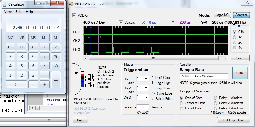

Transmit seems to be ok.. cant really test part there but i can see im sending the right data... i tried 01010101 and see this...
The calculator shows that for 4800bps each bit should be 208us... which is correct in PICKIT2...

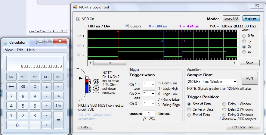

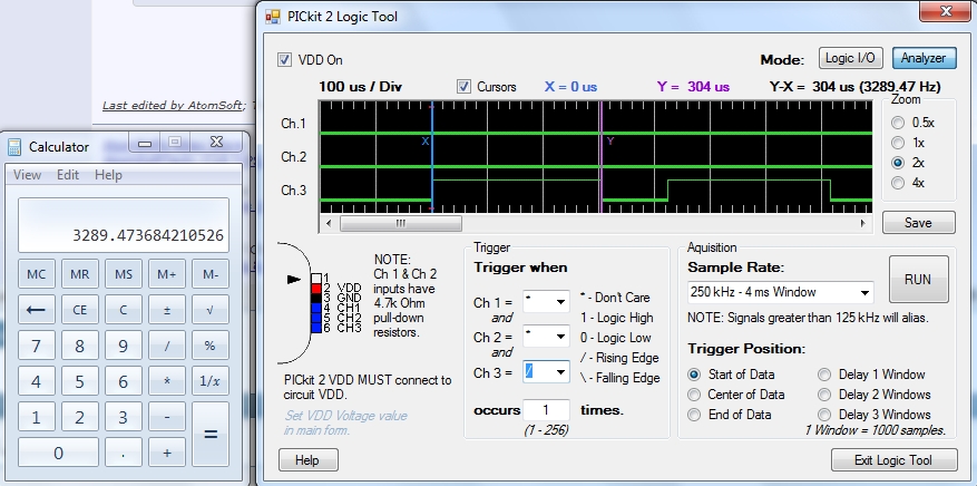

Now here is what im getting from PICKIT2 but using RECEIVER... its a variable speed ...
The Calc shows bps for the selected bit in Analyzer (within pickit 2 software)
LARGE IN: This shows the larger of the 2 bits has a bit rate of 3289bps
SMALL IN: This shows the smaller of the 2 bits has a bit rate of 8333bps

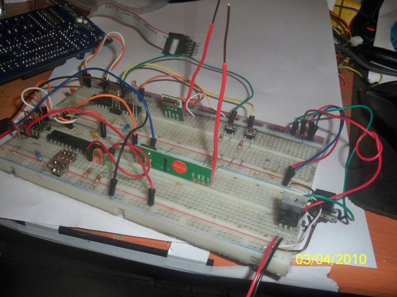

heh ill take a picture of my setup.... and update this post
UPDATE:
100_1391-jpg.39823
