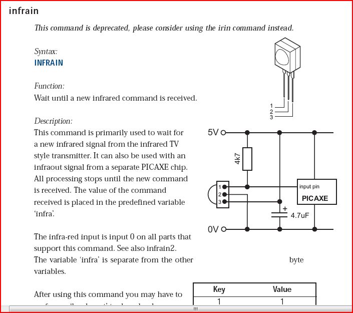

Maybe you might consider using infra red, as it can be made a small compact little circuit.
The way i would do it is to use a picaxe chip as it has built in compatability for IR and a sony remote.
Here is a snipit from the picaxe manual2 that shows how simple the circuit is.
Pete.

The link you showed is controlled by IR similar to what i surgested above.
You can buy a remote control rather cheap here.
https://www.phanderson.com/tv_remote/tv_remote.html
Then just build the receiver end as i had indicated wit using the Picaxe chip as it has the portocol built into it to decode the sony format.
It is a rather simple project using this method.
Phil Anderson in the link above also sells all the picaxe range of chips.
https://www.phanderson.com/picaxe/
For your project i would use a 20m2 0r 20x2 chip so you have lots of outputs to drive the many functions you require.
Pete.
