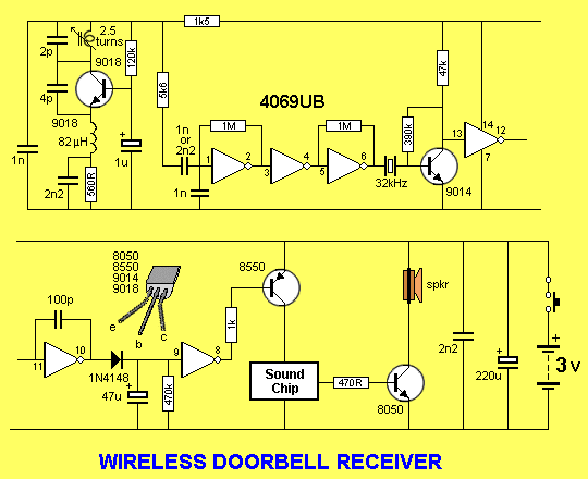

Figure there is a chip that generates the bell chime, was going to find the trigger pin there... Got me curious, so popped it open. The receiver portion is all descreets. Only chip is a 4069, hex inverter. Only bummer is that I don't think I have a relay that works off 3 volts.
A Joule Thief style switcher might be able to make a 5V relay work at 3V.
I am getting 1.5v(+ive) from 2nd pin of IC and around .7v(+ive) from tone generator when the key is pressed..wat are the ways to amplify into 12v from external circuit with external power supply using this trigger except 555 monostable?..

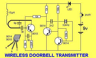

I tested in scope its frequency is 310Mhz.. and i just added little to enormous value of inductor in parallel with the 15uh but the frequency doesnt change.. after connecting some more inductance also the receiver bell is ringing..
I didnt tested by changing cap.
Does anyone knows the solution for this?..
Also the whole information is below
http://www.talkingelectronics.com/projects/WirelessDoorbell/WirelessDoorbell.html
