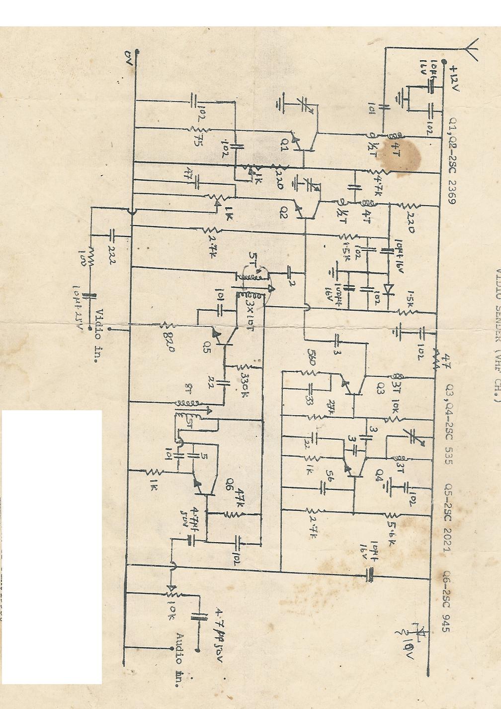

i need a circuit that implement wireless transfer of audio and video data from transmitting devices with AV port (like DVD player, VCR,Satellite decoder, laptop, etc) to receiving devices also with AV port (like TV, Projector and other VDUs ). Thanks

I would use the modulator out of a old VCR or video game. These usually transmit on channel 3 or 4.
You would probably have to boost the output power somewhat with an RF amp for wireless transmission of the signal.

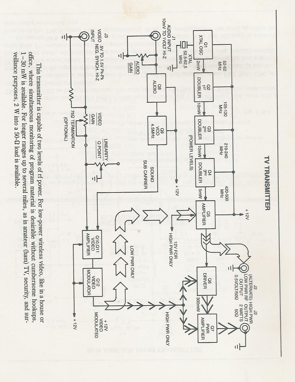

i have attached two type of AV modulators, one is bit complicated and another one can be made by some effort, hope this is what you wanted here..also one page explains about the theory....for PALB system you have to tune audio career to 5.5 MHz.
