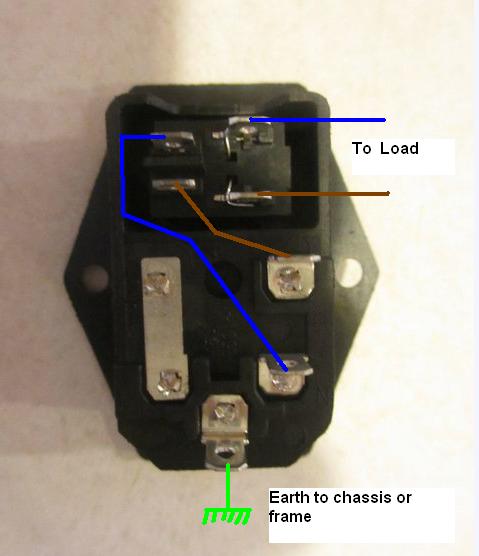

From what I can tell this is how I would expect to wire it with a fuse.
Does this look correct?
Also since I have never done this before I'm not sure what type of wires to use. And can I just solder the wires on or do I need to use special connectors? Any guidance on this subject would be greatly appreciated. Thanks far any and all help.
You do not tell us where in the world you are, so I have drawn the wiring using the UK colours.
Also, your wiring diagram does not display for some reason.

Thanks for the response Jim. Your diagram looks exactly like mine. Thank you for confirming that aspect of my question.

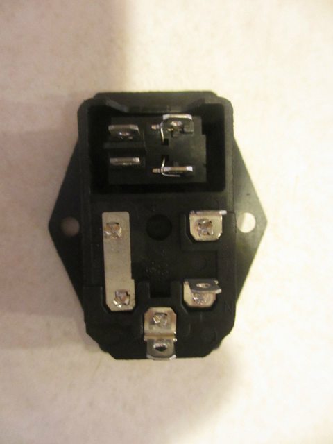

Neither look correct to me. Is the switch illuminated? It looks like the top right pair of tabs are connected to the neon bulb, which makes the switch SPST. This switch should be connected in series with the fuse, from the live/active/hot wire. The neutral wire should connect to the neutral tab. The neon should be connected between the neutral and the switched active (before the fuse); I assume no resistor is required for the neon, though this may not be the case.
Could you possibly draw a diagram of this for me? I am having trouble picturing it.

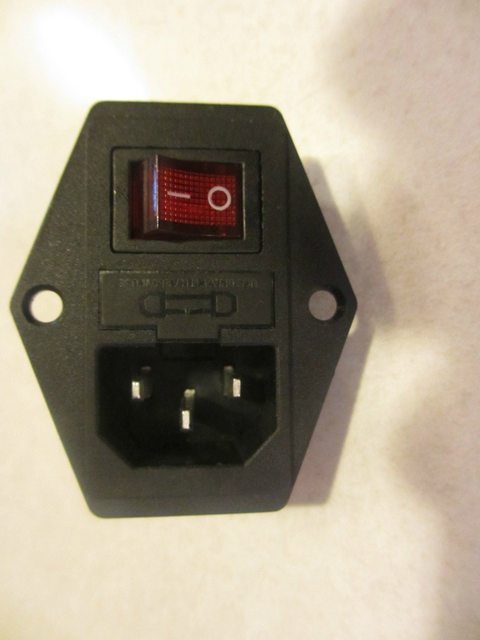

So I just noticed this information on the ebay product page.
Description:
  • 3 pin IEC320 C14 plug, 7 terminals, built in a red light bulb DPST rocker switch, is used widely in lab equipment, medical devices, fitness equipment, industrial automation equipment, etc.
  • Use only with a 250V fuse(fuse not included here).
Notice the DPST. Does this change what your diagram would look like dougy83?
Yes, very much so. It changes it to be exactly what you had in your first post, and JimB showed also.

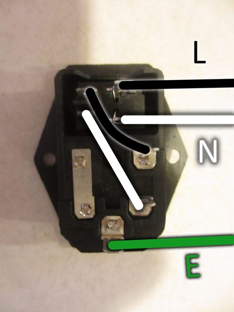

So it turns out that it is to my benefit to swap which side of the switch the L and N wires are on. This would be my new setup if I did this.
Does this still work or will there be an unexpected problem? Thanks for any replies.
Drawn in isolation like that, it is fine.
Depending on the load, if it is critical which is line and which is neutral, there could be a problem. But as far as the connector goes, it does not care.

Thanks for the reply. My question was in reference to just the connector. Getting the wires to the correct position after the switch worked better with them in that position.
Do you know what type of fuse I need to use with this? It says it requires a 250V fuse. Does the amperage matter? And what is the difference between fast blow and slow blow?
That depends on what load you have.
Fuses have a voltage rating as well as a current rating.
If you used a 12volt fuse in 240volt circuit, when the fuse blows it is likely there will be a sustained arc which can do a lot of damage to the fuseholder and equipment.
So here you should use a 250v 20mm fuse. (Usually is 20mm in these things, but do check first).
Yes.
If your load draws 3 amps, you would not want to use a 1 amp fuse, it would soon blow. A 5 amp fuse may be a good choice in that case.
Fuse ratings are complicated, have a look here:
https://en.wikipedia.org/wiki/Fuse_(electrical)
A slow blow fuse will allow short term overloads (a few seconds) without blowing the fuse.
A quick blow fuse responds very quickly to the overload.
