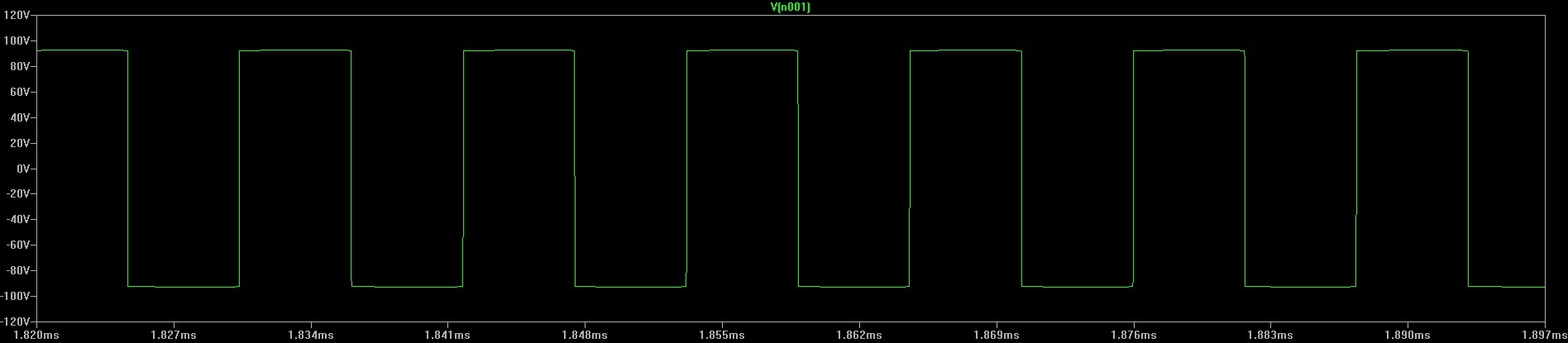

We wish to see if our offline Switch Mode LED lights are immune to noise.
Therefore, we will make a special “noise producer” as in the attached. It is simply an LLC converter with one of its switching nodes dragged out of the enclosure for 30 metres. This 30 metres is loosely twisted (it’s also insulated wire). We will drape this 30 metres of “noisy wire” over our products as they are working –to see if it makes them go wrong.
Do you think any of the products will go wrong when the “noisy wire” is draped over them? Might any operating electronics products be disturbed by being brought near to such a wire?
The waveform of the square wave of the wire is also shown. It is a square wave with 7ns rise time.
LTspice simulation of "noise producer" attached also.
By the way, the LLC converter ('noise producer') shown feeds off the output of a fully isolated full bridge converter, which itself feeds off the output of a 240VAC mains PFC stage.

the wire is 30 meters long, and each side of it is 180 deg out of phase with the other, so the net inductance is close to 0. you might get some noise at 2.5Mhz because your "node" acts as a 1/4w shorted stub transmission line. it's not going to be much noise, and certainly not enough to influence the operation of LEDs.

Your test attempts to impose a broad spectrum of interference onto a test subject. The choice of square wave with a fast rise and fall time does indeed generate considerable spectral components and because there will be strong current flowing in your test wire, the spectrum components will likely have significant strength, however the method used to couple that energy to the device under test is not good. One way that you can improve this test is to open up your 30 meter wire by separating the two conductors and form it into a coil around the test subject. Most of the coupling will be through magnetic field, kind of like a transformer, and your 30m wire makes a poor primary. It will couple considerably more magnetic field if it is formed into a large loop that surrounds the test subject. Another way that you can make your test setup much more effective is to allow the square wave switching frequency to be variable and controlled externally. With this feature, you can sweep the frequency up and down to look for sensitivities that may not be apparent when using only one square wave frequency.
I believe that others perform calibrated testing for electromagnetic compatibility by generating one spectrum component at a time (ie. a sinusoid) and then radiating them, with significant strength, onto the test subject. When dealing with one frequency at a time it is possible to calibrate and know the field strength being imposed onto the device under test and so then be able to compare results to others.
