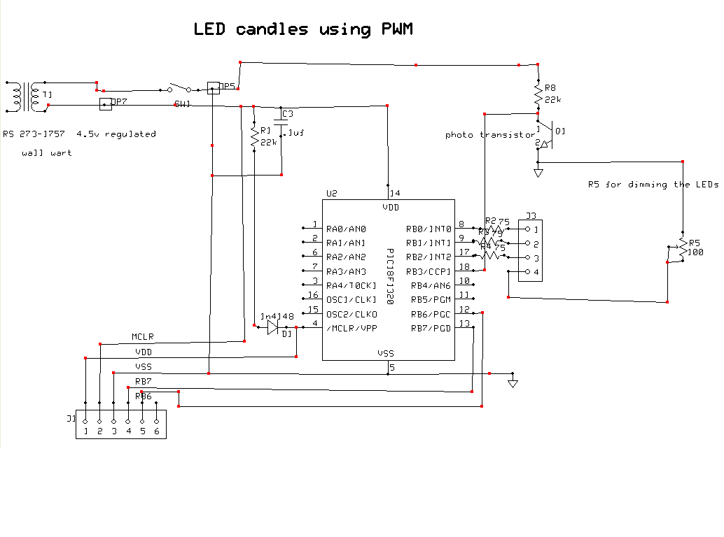

Finally going to build this circuit but really wondering just how good are the RS wal warts?
Thinking maybe adding a diode in series to pin 14?
maybe a 5v zener??
or just don't worry about it?

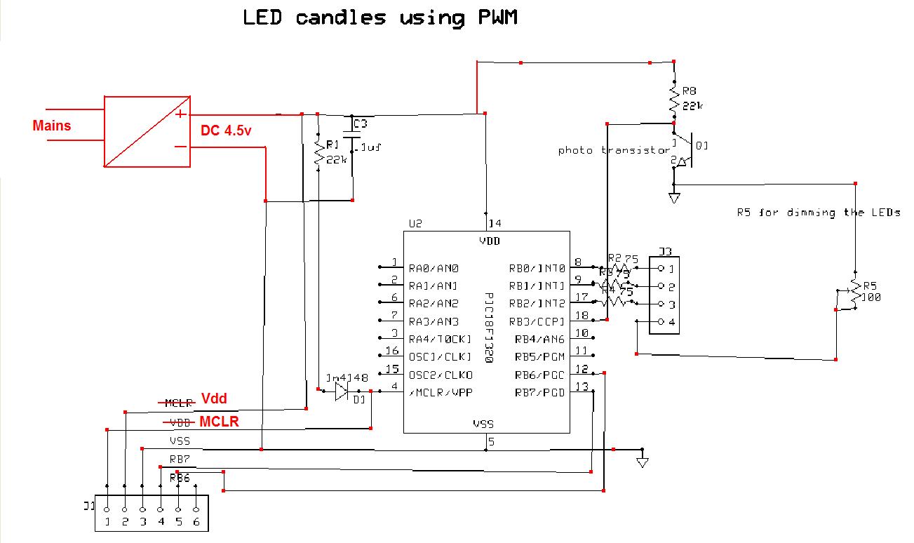

I am not sure about "RS", do you mean "Radio Shack" or the UK company "RS Components".
If its RS Componenets, no problem, if Radio Shack, no idea.
Looking at your circuit, there are a few wrinkles and errors, I have had a go at editing it to remove what seems wrong to me.

oups I guess when I rotated etc the programing port (supposed to be a 5 pin plug) I got the labels switched around.

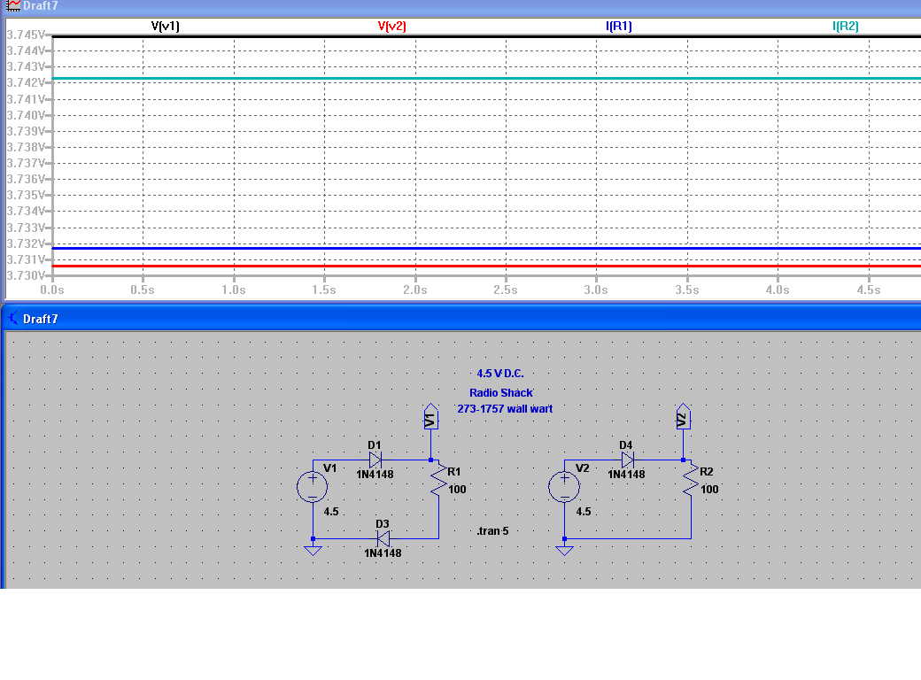

Maybe just insert two diodes and ake a 1/2 wave rectifier?
maYBE OVERKILL OR JUST BEING SAFE?
The power supply kinda has me concerned.
Have a 4.5v Radio Shack wall wart.
woried about how well regulated without going over 5v.
output is two sets of 3 LEDs
see schematic pins 8, 9, 17
each pin drives two LEDs in series
current draw is very min. being the pic is using PWM to drive the LEDs.
R5 is to adjust LED brightness.

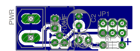

I buy wall warts at the local thrift store for $1 or less. I do not trust the regulation. They are often over voltage or maybe the voltage depends on the load.
I build little PCBs with a regulator, the required 2 caps and a power indicator LED on the regulated side. The PCB has a 2x3 male header that plugs into the power strip of a solderless BB. The wall wart connects to screw terminals. I etch several of the little regulator PCBs at a time and populate them using a regulator with the voltage and current I need for each project.
The current version is for TO-92 package regulators which limits it to 300mA. I like it so well that I plan to make similar ones for larger regulators.

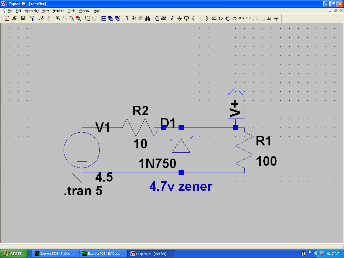

I even contemplated just a simple zener diode to control most over voltage?
this looks promising
just hope local rat shack has a 4.7 zener and a 10 ohm resistor(or close)
very basic. better than nothing at all.

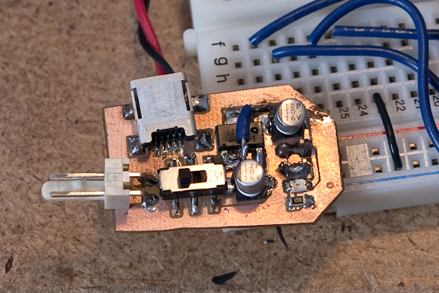

Oh! Oh! I made some of these as well.
Unfortunately my LDO footprint was off, therefor the green wire (actually blue) correction. Mine also have the option to take power from a USB connection, since I tend to do work on my laptop. It does not have RP protection, though, which I should add.
Well my brother went to the big city today and visited a Radio Shack.
only zener found ad bought was a 5.1
I guess using the 5.1 followed with a 1n4148 should keep the voltage below 5v??
input is a 4.5 wal wart from Radio Shack.
better than no insurance of regulation or buying a different wall wart transformer??
any thoughts on this idea?
