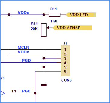

You have a point there. I went a step further.
I have always designed my circuits to use a 6-way ribbon cable, even on all PIC programmers, the first day I started to use PIC. I know that its not standard so I won't recommend anyone to do as I do.
The reason is to have a GND wire between PGD and PGC. Never have any problems of crosstalk.

I have been harping about this for a while. My first suggestion was to use every other line as gnd on the 2x5. People did not like this because if you plugged it in backward everything is shorted to ground. I understand where they are coming from.
This solution swaps the VPP and PGC wires just prior to entering the IDC connectors on both ends. This places both VDD and GND between PGC and PGD which should provide good isolation. The cable is not hard to make and it can be used without modifying the programmer or target.
