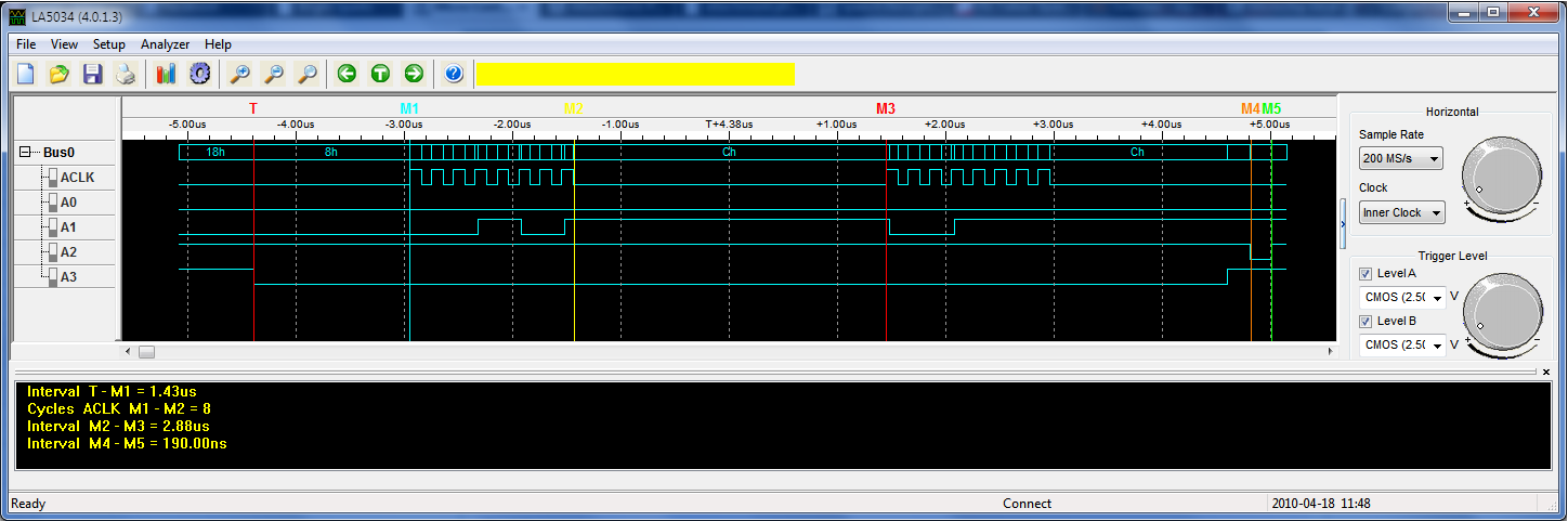

I'm trying to get the DACs working at the moment but I'm having a few problems.
I've followed the data sheet and set up the circuit accordingly, I'm sure I'm sending the the SPI commands and I'm sure I have the correct voltage levels set up.
dac-png.41774

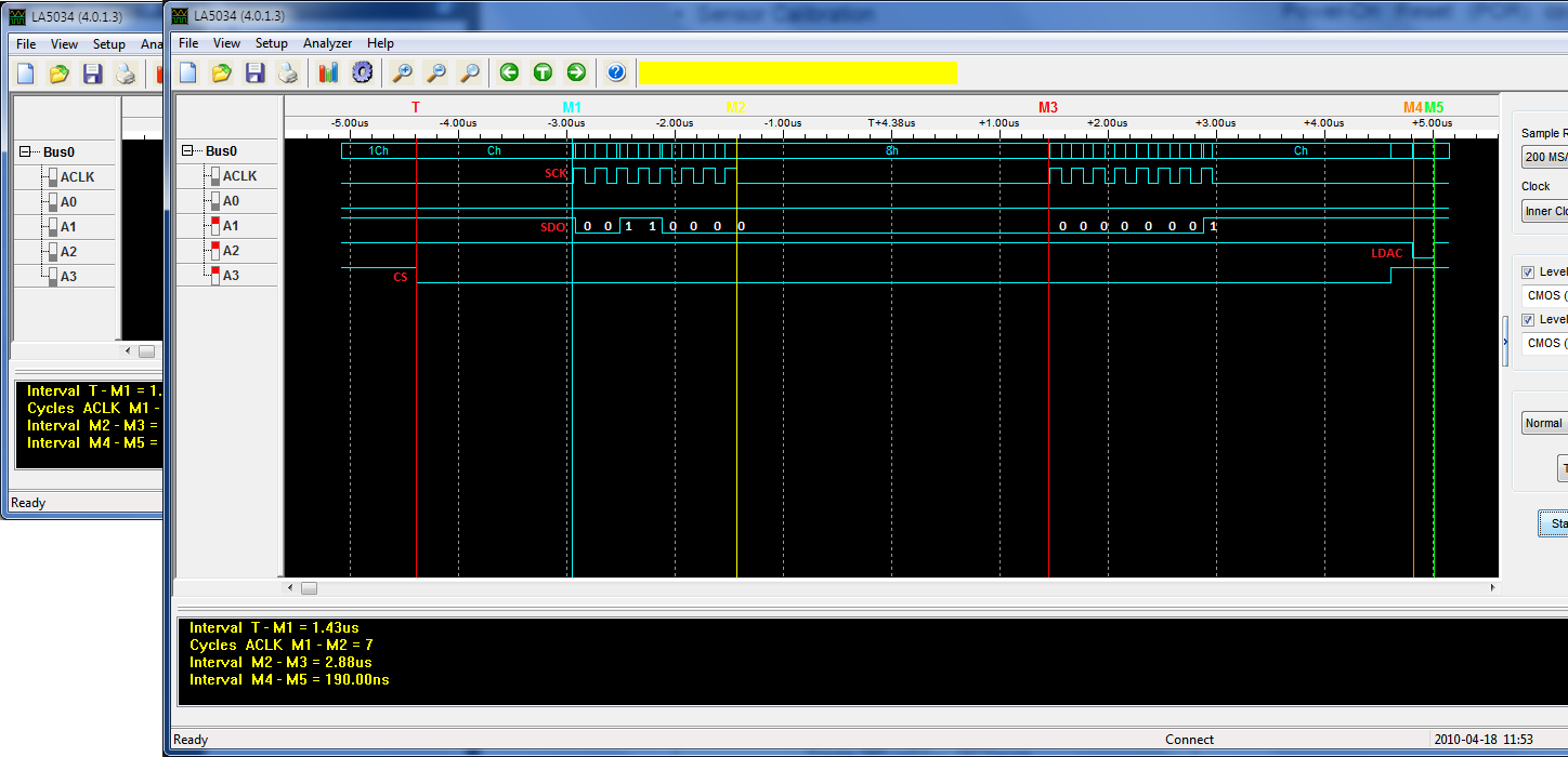

In my first test, I had VREFA connected straight to +5V, When sending a 0x001 to the DAC, the voltage on VOUTA would be +2.4V I've checked the signals with My new Logic analyser and the signals are in-fact correct.
la-png.41776
when I change the config settings to have a 2x gain and set the VREFA to +2.5V using a voltage divider. I get nothing on VOUTA :( no mater what value i set it.
Think you guys could help?

OK it was a mistake on my part.
When I set up the SPI, I set it up to transmit on the falling edge rather than the rising edge of the clock so it was changing the value when the DAC chip was reading the data.
I'm now getting values from 0V to +5V on the output :)
