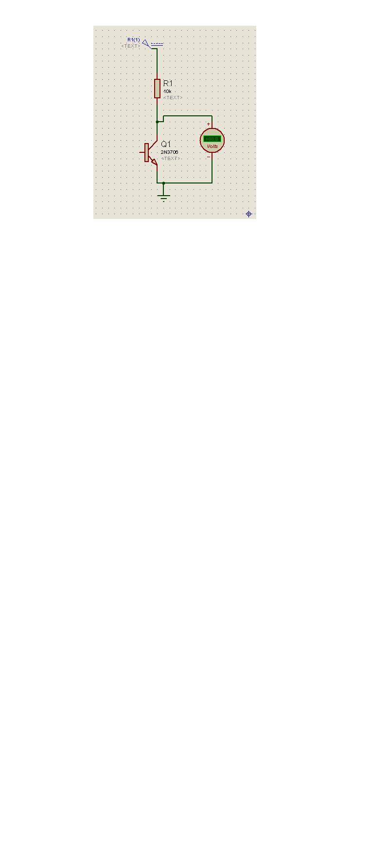

Hi, i bought this photo transistor and connected it as showen in this schematic and it doesnt really work , i used an ultrabright led to shine light on a surface (black and white ) and measure the analog value , no voltage swings between white and black just few mV between both colors.
I tried 1k , 10k , 100k resistors and doesnt swing and 180K resistor it swings but with +- 2V between white and black ...
i dont know how to choose the value of this resistor ?
I think that is a IR (infra red) photo transistor. I can't see the data sheet at the moment.
Have you tried using a regular light bulb (with more IR than a visible LED) and a black/white material that you re sure is not transparent to IR?
Its response peaks at infrared and is half the sensitivity with violet light at the other end of the visible spectrum. Red is at 80% to 90%.
It is sensitive to direct light. With reflected light it needs a very bright light, a very close and reflective surface and a very high value (1M?) for its collector resistor. An amolifier might be needed.

thanks , but from where did you deduce that a 1M can work ? from which part from the datasheet ?
The datasheet says its collector current is from 0.7mA to 5.07mA when a very bright light shines on it.
You said the transistor did not have an output with a 10k or 100k collector resistor. It is 10 times more sensistive with a 1M collector resistor.
The 1M includes the load you have on it. What resistance is the load?

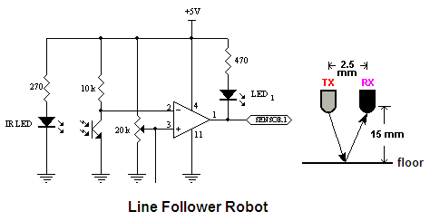

Google has hundreds of links to line follower robot circuits like yours. They use a 10k collector resistor on the photo-transistor and have enough sensitivity.
Maybe yours doesn't work because something is connected wrong?
Check the LED current and the pins on the photo-transistor.
