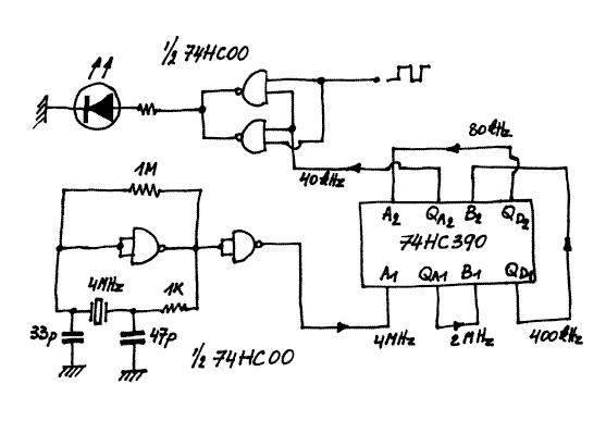

Use a single gate Schmitt Trigger relaxation oscillator. I don't know if it will be suitable for that application or have desirable properties like stability, but it is simple and it is cheap.
El Cheapo 40 kHz source.
Hi Pixelsnpings,
Here's one, of many . . . .
on1aag.

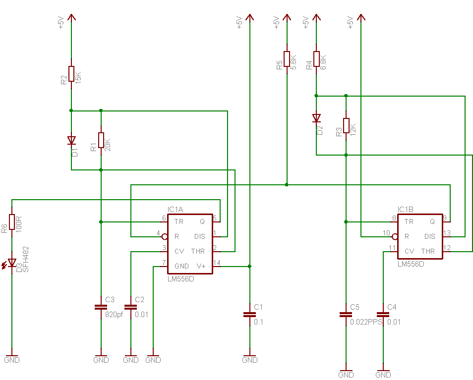

Three suggestions:
1) Check out the Fairchild app note AN-118 on CMOS oscillators;

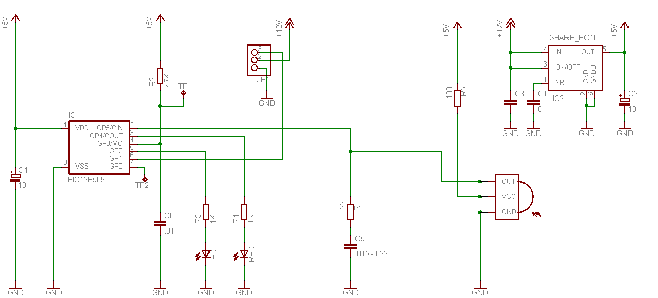

2) Consider using a single PIC chip -- I used a 12F509 for oscillator, modulator, and receiver; parts count was very low compared to making something from the 555 or 556 chips; and
3) See attached schematic for a 38KHz IR oscillator and modulator based on the 556 chip.
In the 556 design, R1/C3 gives approximately 38KHz.
John
Just my $0.02 but a relaxation oscillator with an adjustment seems way simpler then any of the alternatives. Any two chip solution obviously fails the simple test. The requirement was not that the solution work well or even work at all. The absence of the last requirement makes this whole exercise a bit artificial.
Referencing back the the original queston, I assumed the OP would also need modulation of the carrier for any practical purpose using one of the current, receiver-demodulation devices like the Vishay series devices. The 556 is "one-chip":) ; although, I wouldn't argue that point very far. There are so many problems with simple on-off IR that I thought it better to steer the OP in the direction of modulationg the carrier.
Here's the one-chip solution for carrier and modulation, as well as receiver, that I mentioned earlier. I believe it meets the definition of simple, but unfortunately, it uses a PIC. The code is not secret, and I will happily provide it to anyone with a small warning. It was my second attempt post-blinking LED. Therefore, it works, but is not pretty.
John
