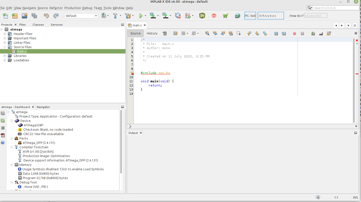

Drop the Arduino IDE and develop in MPLABX.
I just tried setting MPLABX up to program an ATMEGA328p without any problem.
I don't have any chips to try compiling.
