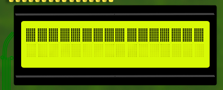

Hi...Thank you very much for simulator. I made smulation and it worked in simulator....But this stupid circuit dosnt work.. I see this display which I sent with atachment ...Help help..I will be crazy lcd.gif
I changed pic..I programmed 3 different pics and tried. no...then I molded a trimpot to third pin of lcd and contacted trim to +5 V....no......this is a little detail of my project but it made 2 month delay..I will be crazy
The trimpot has to be between +5 & gnd with the wiper on pin3
LCDs are very easy to damage. When adjusting contrast you should be able to see black squares.

I put my program to simulator which I got from above. Program works without problem ..but it doesnt work in real circuit. I changed all components of circuit with new equals. can my mistake be in configuration bits..?
Can you confirm that your PIC is operating correctly with a simple LED flashing program?
Is your init code sequence and command correct ?
I use this (for four bit MODE) which works, you should have all of these commands in your initialisation. Your's seems a little short ?
