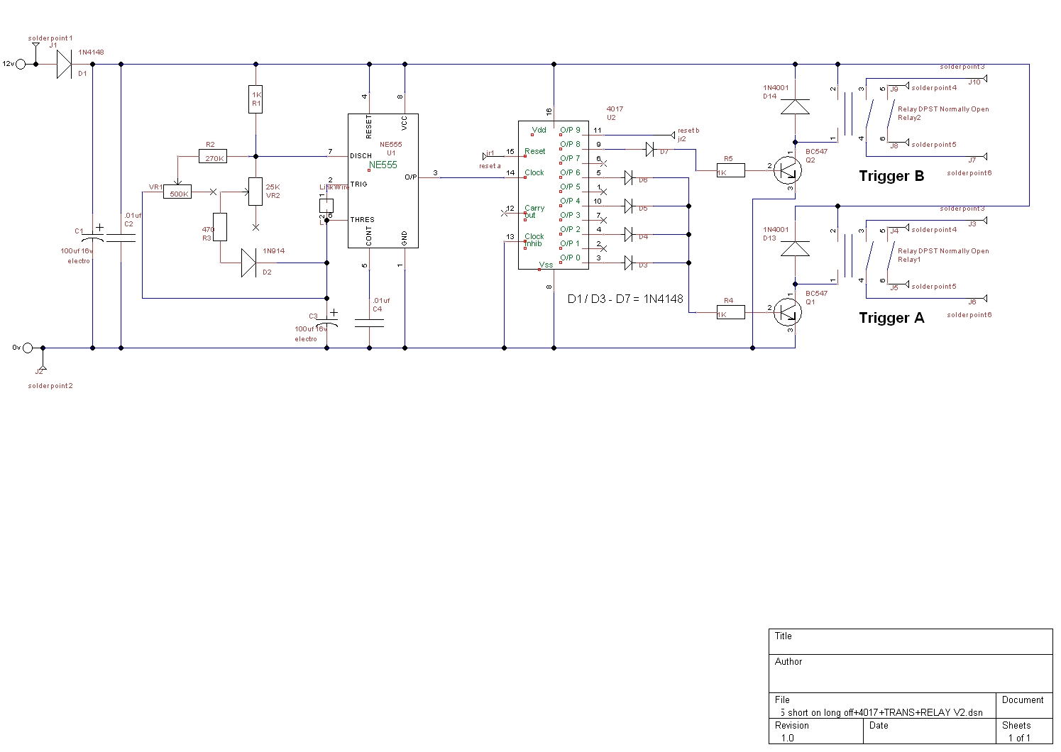

Hi there all
As you can see by the diagram I have used BC547 from a 4017 to trigger a relay. (idea modified from ericgibbs drawing)
Everything works fine but what is happening is the transistor/relay are staying "on" apart from when its being pulsed by the 4017. info confirmed by multi-meter at 4017 & transistor/relay
What I want, is the transistor/relay to be on "ONLY" when the 4017 pulses.
Can anyone please tell me
1. should the transistor be moved to switch a positive voltage or
2. use a different transistor to switch a negative voltage or
3. a different transistor and moved to switch a positive voltage
many thanks
steve

If the relay is working in the opposite sense than you require ie: when the output pin of the 4017 is high, its possible that the BC547 is incorrectly connected.[reversed???]
Also I would add a 47K from the BC547's Base pin to 0V.
Why are you applying a signal (reset b) to pin 11 of the 4017? Pin 11 is an output.
Hi Alec, I think he just has an arrow backwards. Pin 11 is used for a reset.

the "triangle" on pin 11 is mean to represent a soldiering pin

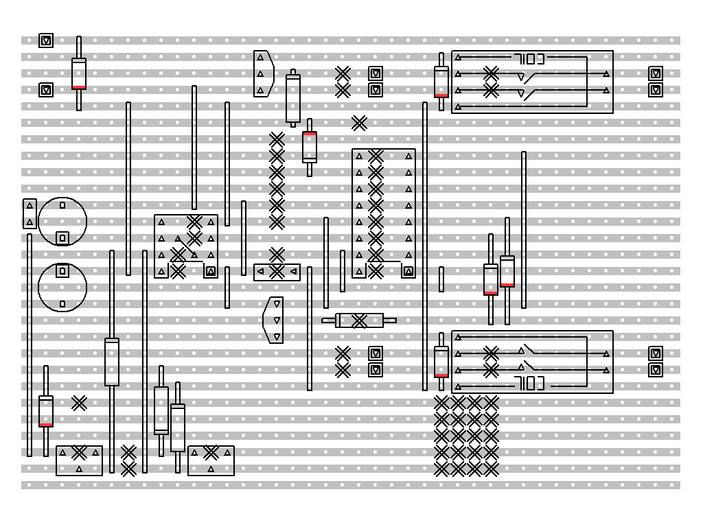

Eric ,, i am fairly certain that the transistors r the right way round even if I had to program* the BC547 into the program *shape & pinouts* (see upload)
The resistors & diodes show a band on then ,, I know this is the wrong way round its what the program (veecad) "does" found out the hard way when nothing worked to begin with, thats why they have red bands now.
Can u tell me why the use of a 47K pull down resistor at the base of the BC547 is it that help with the triggering
cheers
Steve

I have been using tinycad from the drawings and veecad for the stripboard layout, dont think I can upload the files as not covered by file extensisons uploader.

If the transistors are connected to the transistor as shown and the relay way the relay as drawn on post #1, then the relay should only be energised while the 4017 driving pin is high.
What voltages do you measure on the 4017 diode driving pin and the collector of the transistor when the relay is energised.?

Sorry to bring this up now, right after you asked for a break, but how fast are you running your clock to the 4017? I've had the problem of the relay "sticking" at higher frequencies. I think it doesn't have time for the magnetic field inside to dissipate and allow the contact to spring back before another pulse is received. Is it possible that you're running it too quickly?
