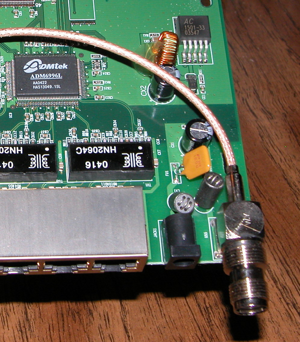

If you search my recent posts, youll see I have a buzzing WRT54G. The power brick is whats doing the buzzing. I discovered that if I removed the PWM chip, it stopped. I purchased a replacement and installed it, and now it still buzzes. This leads me to believe the other chip might have been bad. Since I have no freakin' clue whats wrong with it, Im left replacing chips until it works again. Anyways, I need an equivalent to a chip with the following markings. I google'd it and couldnt find any matches in terms of the markings.
9936
:delta:31B9M
It is an 8-pin SOIC chip, located right at the power input. I can try and get a close-up picture of the location of the chip if it will help.

To be honest, I would have thought the least likely cause is going to be a faulty IC - as suggested FAR more likely is the transformer mechanically noisey, or a faulty capacitor.
whichever electrolytics there are, replace 'em both, they're cheap!
I see two on my wrt54g rev 1
oh, that's not your board ... but if yours look like that, with no visual signs of distress, I'd be highly suspect of anything being wrong with the caps.
if you still want to replace any, replace all four, two big ones and two little ones.
Thats exactly what my board looks like. No visual signs of wear or anything. Thats why I suspected the chip, because when I removed it the buzzing stopped, but it obviously still doesnt work.

You should be able to easily identify the output from the transformer, through a rectifier, with a capacitor or two to ground - check on ohms across the diode and capacitors.
Do you suspect any bulge on top od caps? If not, try to replace the power brick , if you have a suitable one -- i am suspecting high ripple from that
For the xformer and rectifier, you mean crack open the power brick and check, right? There is no xformer or rectifier on the board itself. As for testing caps. What should I be looking for when I first apply the leads? After ten seconds?
