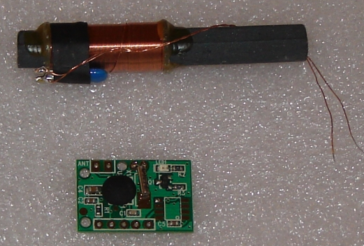

That was my thought too. I happen to be writing my own code (asm). I found one example online, but I think it tries to do too much (https://www.ringolake.com/pic_proj/WWVB/wwvb.html ). Presumably, a CMMR-6 equivalent receiver is in the mail to me from the UK (https://www.sparkfun.com/datasheets/Wireless/General/CMMR-6P-A2-1.pdf ). The receiver on order is described as being the same receiver, but with a COB instead of SMD device.
I think I will just ignore the fractions of a second and stick to UTC. An RTC will be used to cover those times that WWVB can't be received. I know I can buy a cheap clock that does the same thing, but I need to keep busy on something useless.

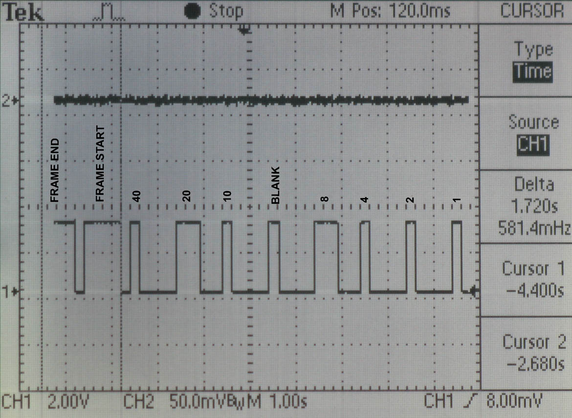

My WWVB receiver arrived today from PV Electronics (brand = SYM-RFT) and it works:
The signal is inverted, and I had to wait until late to get a good signal. Here it is on a 'scope at 0228 hours:
The biggest problem I have right now is my older TEK 210 scope puts out so much emf trash that it blanks out the WWVB signal. Had to erect all sort of shields from pastry trays to get the image. When that scope is off, my much older TEK 2235 does a great job and doesn't cause any noticeable interference, but I can't capture the screen. If it were't so fun, there are easier ways to get the correct time.

I expected interference from cheap switchers, but not from a Tektronics scope several feet away. Another design using the original CMMR-6 receiver had to shield the antenna from the LCD display. Aside from the scope problem, I got pretty stable reception in my log home late at night. It was a little sporadic during the day, so I coded a simulator to facilitate coding the receiver. Once that is all done, I will fiddle with antennas and certainly refer back to the link you provide. I would like the clock to be usable in the same room I have my other electronic toys.
