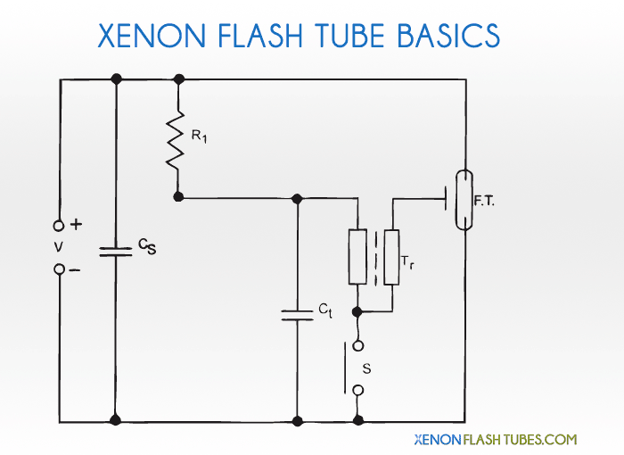

I need help with this circuit. F.T. Capacitor Cs is 330V 800uf, Ct is 400V 0.047uF, resistor is 5.1M, triger coil is TC-36.
In this circuit capacitor Cs discharge through flash tube with full power.
I want to control discharging power in steps of 1/2, 1/4, 1/8 ...
How this can be done?

If you add a rotary switch and extra Cs capacitors you could switch the extra Cs caps in & out, different values can be used to store different amounts of energy.
If you do this for safety put 470k resistors across the caps to discharge them when switched out of circuit.
Remember that current limiting can be reduced by ESR and series L but causes resonance with flash source capacitance and Q is L/ESR(total). Also energy transferred to flash is limited by storage cap dump voltage and V or C values used such that E=1/2 CV^2
So you can select different V with DC-DC regulator or different C with switches as Dr Pepper pointed out.

Basically, to reduce the power you can:
  1. use different sized Cs (as mentioned by dr pepper, above),
  2. change the charge voltage on Cs (requires a low-current-switching device in series with the charging supply), or
  3. control the conduction time of the lamp (requires a high-current-switching device in series with the lamp).

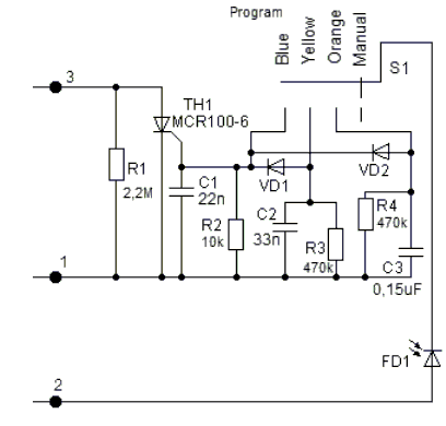

Anyway, I want to figure out principle of old manual flashes and implement it in my project.

High-current-switching device? Any link for circuit?
I found this on some russian site, it is circuit board marked EPT260-01B.
But, where are wires 1,2 and 3 connected?
