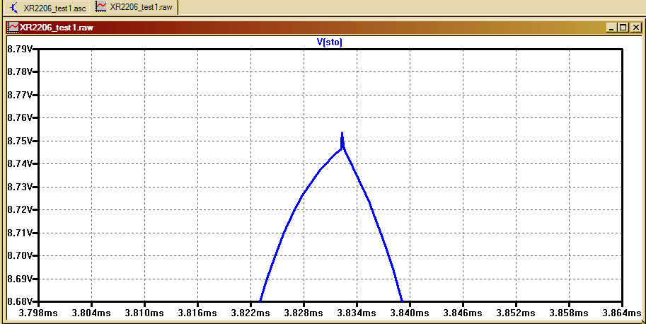

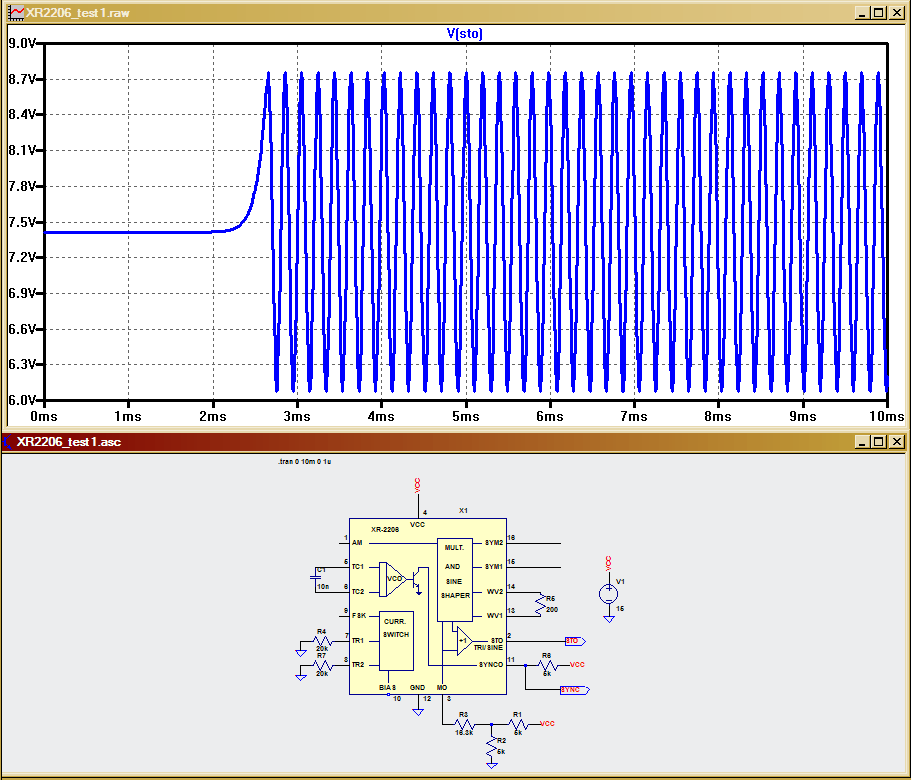

Has anyone any experience with the**broken link removed** Function generator IC, Im prototyping a function generator design based on the XR2206, but Im having trouble with distortion on the positive peaks of sine o/p. The distortion is present for the full range of frequencies and is not affected by DC offset or amplitude... .Adjusting the symmetry (22k pot) makes no difference either.
+VCC = 5v and -VCC = -5V
Sine @ Pin 2
Zoomed in on the peak...
Do you still get that glitch when the CD40106 is disconnected.??
Forgot to mention that neither the CD40106 or the TL-072 are connected at the moment, so to answer your question... yes.
These images are from a LTspice simulation I have just done, the spike is also on the Sim, it must be a design problem.????
Very strange....

I believe the XR2206 generates a sine wave by diode shaping of the triangle wave. There is apparently a small glitch that is generated at the peak of the triangle wave, which is also the transition point of the square-wave output.
You might try a high frequency low-pass filter, with a break frequency slightly above the highest frequency you plan on generating, on the output to suppress the glitch. The oscilloscope picture shows a glitch rise-time of about 200ns which translates to a frequency of about 1.75MHz. Thus a low-pass filter of 1MHz or lower would provide some suppression of the glitch. Configuring the output op amp as a 2nd-order low-pass active filter would improve the suppression over a simple 1-pole RC passive filter. Active Filter Design Application - FILTERPRO - TI Software Folder will help with the active filter design.

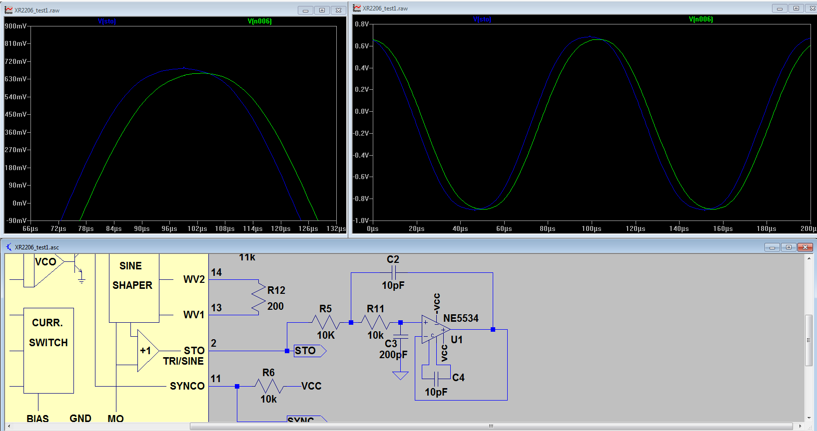

Yes, I think the TI software is wrong I tried another filter design app and the required GBW was quoted as 1.818MHz which seems more reasonble. However I went ahead and simulated the filter design produced with the TI app, but it only barely rounded the tip of the glitch so I experimented with the values of the components and eventually settled on changing C3 from 10pF to 200pF which seems to have sorted it(see attachment) . What do you think?

Thanks, that does look like an amazing opamp! but it comes at a cost $$$$. I dont think I need such a high spec for this application -The NE5534 seems to be doing the trick!

It seems I spoke too soon, naively I only simulated the filter with an input of 10KHz, realizing this I altered the values of timing capacitor and resistor to get a 1MHz O/P but the XR2206 model doesn't seem to want to go past 90KHz so I settled for testing at that frequency. The results were disappointing -300mV attenuation.
I set C3 back to the value calculated to by the TI app and sure enough the attenuation was almost completely reduced at the same time filtering out the glitch.
It looks to me like I may need to use a different filter topology in order to effectively filter out the glitch for the full range of input frequencies while limiting the amount of attenuation.
As Iv said though my knowledge in the area of active filter design is lacking.
Anyone, any suggestions?
A Sallen and Key second order Butterworth lowpass filter is non-inverting and has C2 double the value of C3.
If it cuts 1MHz by -3dB then it will have very little effect on the distortion.
