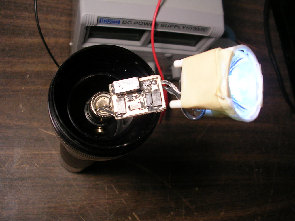

I know I've said that I finished my LED light project before but it was pretty flawed- The DC-DC converter chip that I used was a piece of crap, the flashlight that it was housed in got thrashed by me :lol: , the circuit was ready to fall apart because it was so fragile.
This time though, I used the zxsc400 DC-DC converter which only drops the output 1mA from 8volts all the way down to 1.8volts. In reality though this circuit works down to about 1.5volts. I also used a reflector made specifically for this LED, so much more of the light makes it where you want it to go.
When I get some more time I'll post a complete how-to in the projects section.
The only thing questionable on this circuit is that the inductor is warm to the touch. I'll have to get another one with a higher Q perhaps.
thanks for sending your project and also for giving info. about your project.but i have an query i.e. which component you have used in your projet.one component look like a speakar.does it is?
