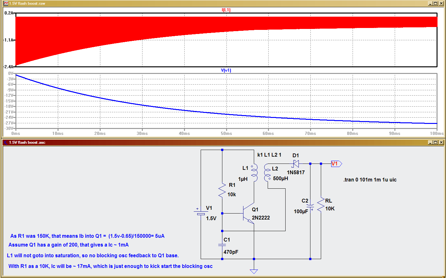

Thanks, Simon. Turns out I already knew about coupling inductors using Kn statements. The problem is that I don't know the actual inductances of my transformer. I tried measuring it today (I built an inductance adapter for a multimeter that works very well), but couldn't even get a reading, so I ASS-U-ME it's below the threshold of my test equipment, possibly in the nanohenry range.
In any case, I did model the circuit (.asc attached below):
The long and short of it is, it just plain don't work. Can't get it to start oscillating at all. Tried adding and removing "startup" and "UIC"; no difference. Played with the inductor values, tried different transistors, nothing. Now, I know this circuit works in real life. I wonder what conditions aren't being met in order for LTspice to start this? Base drive for the transistor too low? not enough feedback?

The problems not with LTS, its with your circuit.
Look at the notes and changes on this image.
LTS is not a circuit designer or circuit design tutorial, its only a simulator. If you make basic design errors in your circuits, LTS will not correct your mistakes.
I would advise you to calculate the circuit parameters/values by hand, using the datasheets etc, before using the simulator to check your results.

cz,
Well, regarding your notes (and comments here), all I can say is, it works on my test bench. Kind of the opposite of the usual situation, where something works in simulation but not in real life.
So how do you explain that? I don't doubt the calculations you made in your notes. But the fact remains that this is a working circuit that Spice can't seem to simulate.

The LTS uses typical values for its semiconductors and other components. The fact that the built version works could be any number of factors, including circuit layout, component tolerances.
Hand wound transformers on unknown core materials can vary a lot in their inductance and coupling.
I think most of us has built a one off prototype that works and later find that 'identical' production circuits will not oscillate. The design should try to cater for worst case conditions.
