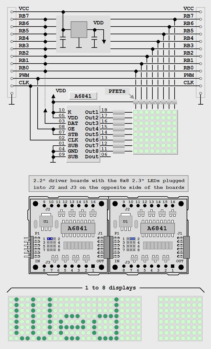

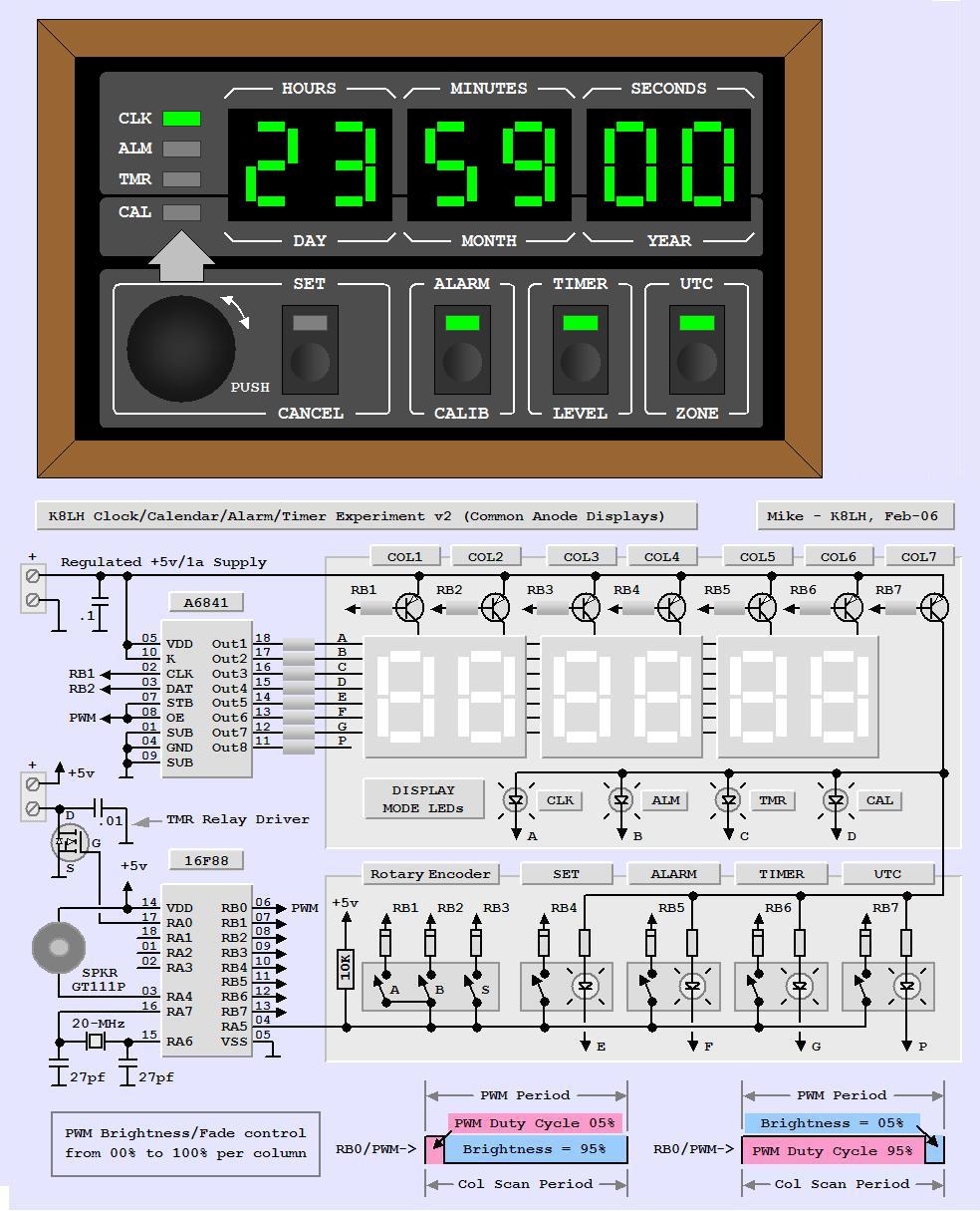

On a somewhat related note -- yesterday I designed a more "traditional" multiplexed circuit for my Clock project (below) and this morning I wired up the 16F88, MIC5841, and the COL1/COL2 LEDs on a solderless breadboard and had full PWM fading test code debugged and running in a couple hours...
Absolutely incredible brightness on the green displays that I'm using and I suspect probably more than enough drive for those exotic new 1.0" white and 4.0" blue displays I've seen... And not only can I change brightness level on the entire display to match room lighting conditions, I can also change the brightness level per column or digit for some interesting special effects... I originally just wanted to smoothly fade the display to black and back momentarily when switching modes (CLK, ALM, TMR, CAL) but now I can't wait to test code that would fade changing clock digits for a pseudo 'morph' effect... I'm really 'geeked' (grin)...
Regards, Mike

Hi Mike,I don't mean to carry it off the topic,but I wonder what software you were using as shown in your picture attachment. :)
Hi Alex,
The drawings are Excel 2000 spreadsheets...
Take care... Regards, Mike

Thanks Mike,I thought it was an advanced simulation software which I had never seen before.I have Proteus on my school PC,and it simulats analogue circuits as well as microcontrollers.You construct the scheme with the uC you want,and import its code.Then the software runs the code inside the virtual uC.The effect looks so real!
BTW I prefer editing my graphic scripts with MSpaint,save it as gif or jpg file.Only when I don't need high quality :)
