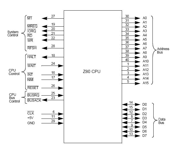

So basically what you say is that i need extern memory and i/o modules ?
Even if i just want the processor to flash some leds ? The processor got 20pins on each side (total of 40 pins), so i assumed some of them was i/o pins ?
If it is a Z80, then 8 of them are data lines (for external memory) 16 of them are address lines (for external memory) and the rest are things like /RD and /WR, Halt, external interrupts etc.
You will also need an external clock, i.e. you can't just hang a crystal or a resonator on a Z80.

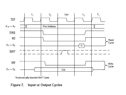

well, if you have bought 10 Z80's then you wouldnt restrict yourself to just flashing LEDs, right??? a microprocessor system always needs a number of other chips for it to work depending on the requirement of the system. you will need interfacing chips, memory chips etc. the amount and type of these chips will depend on your application and the CPU you have chosen. a better alternative is to use a microcontroller. a microcontroller has alot of things built on a single chip. that makes life much easier. but i wouldnt say that you abandon the Z80. look for Z80 projects around the internet (use google as williB suggested).
it can be done , its no easy task though.
on the trs 80 system the data and address bus was multiplexed, but you dont have to do it that way.
you still need the I/O ie .. parallel periferial Interface chip..because the z80 WILL output data to blink LEDs but you just cant drive an LED with the data bus output..but you could use a LS 245 i believe ..., to latch the data .using either IOREQ or WR lines or both
