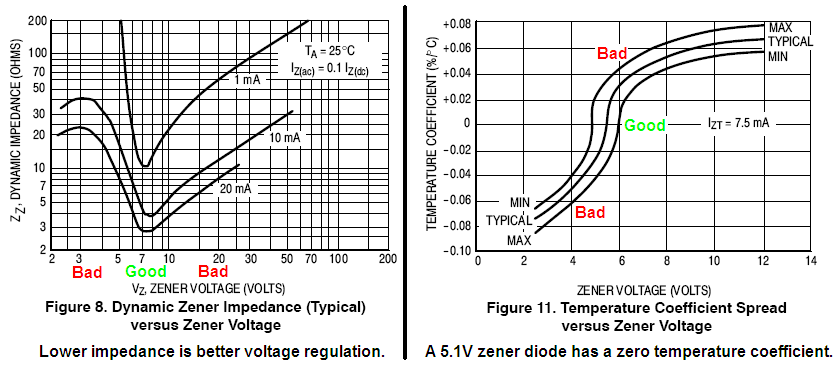

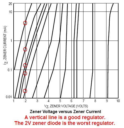

I agree that a low voltage zener diode has poor voltage regulation. Its voltage also changes as its temperature changes.
Here are some graphs that show impedance and the voltage increasing as the current increases:
