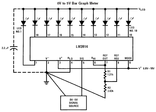

hello guys can anyone figure out how the LM3914 zero-crossing detector in the link below works? i've posted this on another forum and we're all agreed that the 3914 in the circuit had been used strangely...

It's only strange in that it's been fed from the AC input, as the article says, it will only respond to the positive side of the signal, and when it becomes positive enough to light that particular LED it will generate a logic signal.
It seems rather a waste of a 3914 though?, surely a simple comparator would do the job much more simply.

i was just wondering, couldn't his intention have been pin 10 and not 17?
i believe led 10 is the first to turn on and the last to go off? hence connecting the input to the buffer could give us a zero crossing detector?
Pin 1 is the most sensitive LED output. It goes low when the DC input voltage to the LM3914 exceeds 10% of the reference-out voltage that is set with a trimpot.
Pin 17 goes low when the input voltage exceeds 30% of the ref-out voltage so the LM3914 definitely isn't a zero-crossing detector, no matter which pin is used. :cry:
darn! that seems to be the final nail on the circuit's coffin. i'll replace it with an opamp zero-crossing detector... but that mistake still give me the doubts over the whole circuit and its associated code.

a second question pls, the LED's cathodes are connected to the internal comparator's output. when there's a coincidence at it's input the output swings to high, right? wouldn't that be making the cathode to be at the same potential with the anode? how then does the led light up?
The LED lights when the output goes low.

You want this A to D circuit to operate at frequencies higher than only 1kHz?
1) The old LM324 quad opamp is about as slow as they get. Use a much newer, faster opamp.
2) The 20us sample time for the sample-and-hold stage allows a max frequency of only about 3kHz for terrible 16-steps per cycle resolution.
Use a much shorter sample time.
3) The oscillator in the ADC operates at only 640kHz. Use a much higher frequency for good resolution at higher frequencies.
4) The pc's printer port is very slow with a conversion time of only 100us, which gives a terrible 16-steps per cycle resolution at only 625Hz. Use a USB interface. :lol:

I'll add to that:
5) The input resistance is very low and nonlinear (about 900 ohms for negative inputs, 300 ohms for positive).
If you use an op amp as a zero crossing detector, it has to be able to handle the negative input voltages (a series resistor might suffice). The LM3914 is designed to handle negative inputs, but, as has been pointed out, it is a lousy zero-crossing detector.

aibelectronics said:
the LM 3914 was the best option to use, this is because the associated code requires pin 15 to be HIGH throughout the duration that the signal is negative, to enable it plot the negative part of the signal.
A comparator IC does the same thing, but its output changes at exactly the zero crossings. None of the comparator outputs of an LM3914 change at a zero crossing.
On the other hand a 'proper' zero crossing detector only goes high when the signal crosses through zero.
Not true. A zero crossing detector's output changes its polarity at each zero crossing.

As I see it the circuit doesn't need a 'zero-crossing' detector?, and the LM3914 doesn't pretend to be any such device. It's using just one of the comparators out of the chip, so it would be simpler to use a single comparator in it's place, which would also allow you to simply adjust the switching point with a preset.
This would simplify the design, reduce it's cost, and give better functionality - the LM3914 is a completely bizarre choice?.
