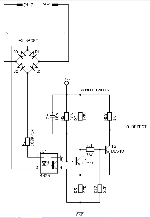

A zero-crossing unit and a square wave generator are two different things.
The zero-crossing unit has its input mains frequency derived via an optocoupler, whereas a square wave generator (oscillator) has its frequency decisive R and C.
Here is a typical zero-crossing unit with Schmitt-Trigger output. The Schmitt-Trigger takes care of clean square wave output wave shape.
R1 is calculated for a mains voltage of 230VAC.

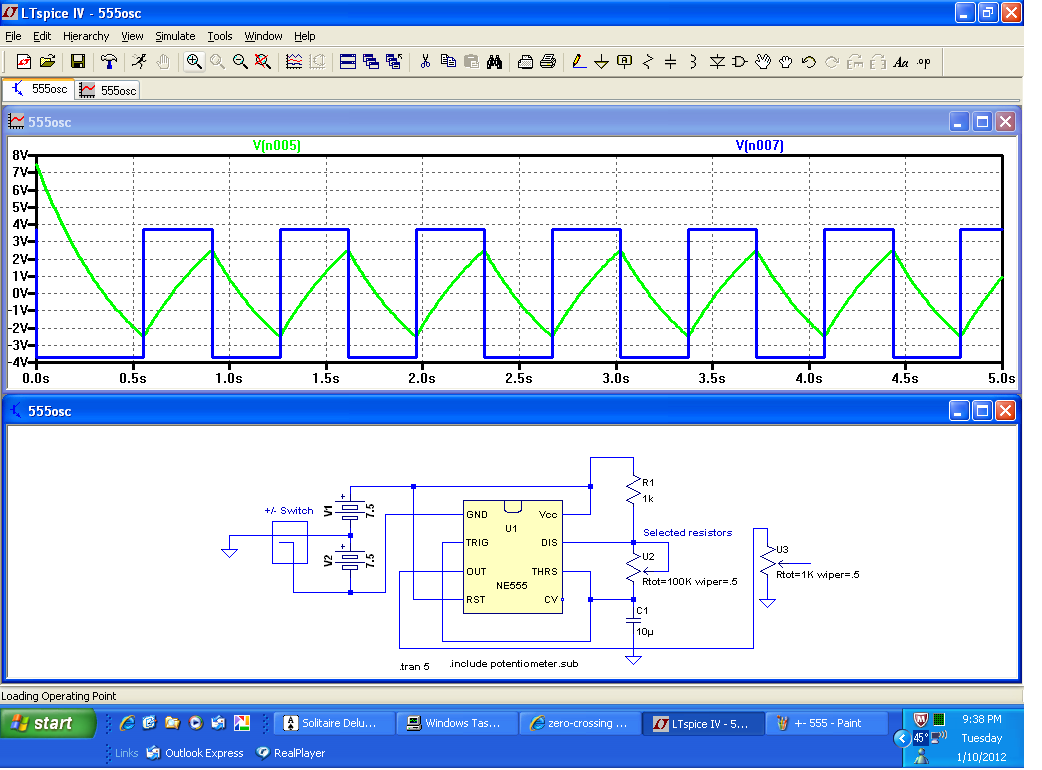

Okay. Sorry for not being specific enough. I will try to explain:
I want to construct a portable 18vdc frequency calibrator. It will be used to simulate output from a variable reluctance sensor on turbine flow meter. The ideal output is a squarewave of 15 volt peak-to-peak amplitude which can be set to any lower value with a built-in attenuator (e.g. sliding potentiometer). I would love a switch to select zero based or zero center outputs for standard or zero crossing inputs. A frequency range from 1hz to 6khz would be the cats pajamas.

Actually that was supposed to read 60Khz. So, yep I would like to do it in steps 1Hz - 60Khz. An amplitude of 0 to 15 volts and minus 7.5 to plus 7.5 volts is what I am shooting for. what do you think about using a 15V operated 555 in astable mode. If pin 3 is fed back to pins 2 and 6, through a resistor, I can get a 50% duty ratio square wave. Can I use a combination of pot and fixed resistor, selected by a switch to get various fixed frequencies from 1hz to 60kHz, say 1,10,100,1000 ... 60000 hz.
Sure, Here is a 555 that will get you almost there. The pot can be replaced with a switch with selected resistors for the frequencies you need. The part in the box represents a switch to give the +/- pulse or the 0 to 15 volt pulse.
You Rock! I'm gonna give it a shot later this week and let you know how it turns out. Thanks Again!!!
