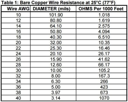

Wire gauge R per foot -
So if you had a run of 100' 10 gauge then it would read ~ .1018 ohms which many low cost
meters cannot do accurately. And thats if one probe is at 100', one at 0'. In other words if you
are trying to do this at a socket then you have to account for R in the ground path. And that
would be low as well in this example. This is just not a good way to determine a short. Note I
am not an Electrician.....

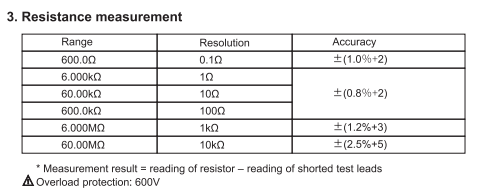

You have to have a decent ohmmeter to read low R values, what model do you have ? Read its
operating/user manual to see what accuracy yours has.
Regards, Dana.
Notice the resolution is .1 ohms so using a meter for your intended purpose,
in general, not a good idea.
Add to this measurement attempt junction boxes in the path, and the resistance of screw connections,
old ones with more oxidation add to problem, as well as wire strain on the connection with
poor contact/compression.
Regards, Dana.
Regards, Dana.
