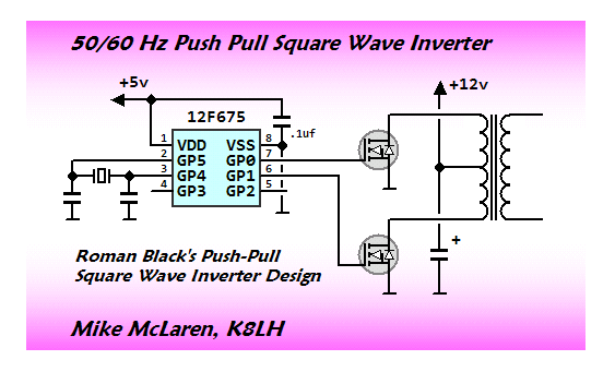

Ok, with all the talk of inverters on the forum lately I whipped up a couple of projects. This one is a xtal-locked zero-jitter push-pull inverter that will output 50Hz with a 10Mhz xtal, or 60Hz with a 12MHz xtal (using the same code).
Code is fully tested and works very nicely, it uses the zero-jitter example above but generates 8 times the mains frequency, then the two push-pull outputs are sequenced like this;
GP0 - 01110000
GP1 - 00000111
This makes a pretty decent push-pull squarewave so it can be connected directly to a pair of FETs, so basically this is the entire code for a xtal-locked mains inverter for times when you need a very precise mains frequency generated;
  ZJ_Inverter.c   xtal-locked push-pull Inverter driver
  Open-source  -  30 Nov 2009  -  www.RomanBlack.com/one_sec.htm
  PIC 12F675, xtal (see below).
  This was based on my ZEZJ system for generating a frequency.
  It will drive push-pull FETs to make a mains inverter;
    10MHz xtal; 50Hz output (same code is used for both)
    12MHz xtal; 60Hz output
  GP0 - this is push-pull outputA (hi = FET on)
  GP1 - this is push-pull outputB (hi = FET on)
_BODEN_OFF _MCLRE_OFF _PWRTE_ON _WDT_OFF _HSOSC

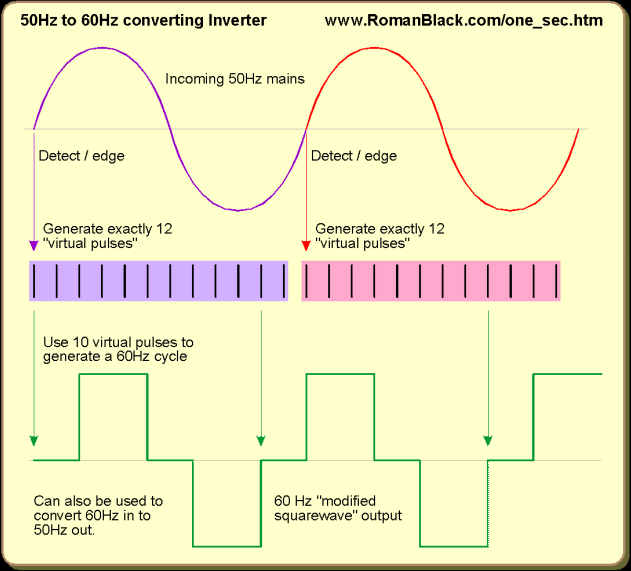

This next one came out very nice, I am quite pleased with it considering the very small simple code. It is a mains-locked 50Hz to 60Hz converter with push-pull inverter outputs basically its a complete inverter that sync-locks to the mains frequency.
This has been discussed a bit recently, for people who want to run old 60Hz clocks on 50Hz or vice versa.
The procedure is simplicity itself;
1. 4MHz xtal generates error corrected 600Hz pulses
2. Each incoming 50Hz mains cycle causes 12 pulses to be generated.
3. Every 10 pulses it generates a 60Hz push-pull cycle.
(it works perfectly for 60Hz to 50Hz conversion too, just edit one line of code)
This is the entire brain for a proper mains-locked freq-converting inverter so you can run old clocks from different frequency mains. Code is fully tested and looks VERY nice on the CRO; :D
  ZE_MainsConverter.c   mains freq converter push-pull inverter driver

These push-pull inverters are also on my zero-error timing routines page;

rb-sine-wave-2-png.36069

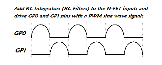

Now correct me if I'm wrong but couldn't we just drive the N-FET inputs with filtered sine wave patterns like those below to produce sine wave output instead of square wave output?
rb-sine-wave-1-png.36070
If that's all that's required then I think it could be done quite easily without a CCP module or timer modules using just a simple isochronous loop. I'll take a try at this code in the next few days.
Regards, Mike

You made a beautiful schematic image (as always ;)) but it's probably best described as "Ultra-simple push-pull modified square wave inverter" rather than using my name as it is really a standard push pull inverter topology, just using the minimum parts that will actually do the job.
That's tiny code for getting the job done. It would be nice to include the macro too if someone wants to build it. This page looks like it's becoming a resource for building tiny inverters which is pretty cool. :)
As for using the RC filters and driving the FETs with analog sines, that's a bad idea because it runs the FETs in the linear region where they will dissipate a lot of power so inverter efficiency is low and the FETs now need to be big and have big heatsinks.
Your original PWM sine is far better for efficiency, provided of course it has the dual push-pull PIC outputs.

(edit) This only makes a single PWM sine output, so if push-pull outputs are needed it requires a hardware inverter to generate outputB by generating and inverted outputA. A transistor and couple of resistors would be enough to do the hardware inversion.
Not sure I follow your 50 to 60 Hz convertors but anyway, is this the sine table you're looking for?

(edit) Here are a couple of pictures showing how the mains freq-locked 50Hz to 60Hz conversion works and why it only needs such simple code; :)
