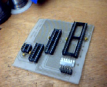

Hey,
I recently purchased an Inchworm programmer but I need a way of connecting it to a ZIF socket. I'm getting tired of using the wires and breadboard approach. Anyone know how to connect the socket so it can support most PICs? I usually use 8 and 16 pin PICs but I'm planning to upgrade to 28 and 40 pin PICs. I'm looking to do something like this except I'm not planning to do the in circuit programming thing:

Well, you can look at the diagram of other programmers to figure this out:
https://www.electro-tech-online.com/custompdfs/2008/04/p16pro40-1.pdf
Take note of the insertion instructions on the right hand side of the diagram.
But bear in mind the P16PRO40 uses TWO separate Vpp lines, which the InchWorm can't provide. With a little thought though, you should be able to fit a switch to steer Vpp to the correct lines.

It's not a question of the 'range', it's a question of the size of the PIC and where the programming pins are. If you don't switch the Vpp connection correctly, you're going to be applying 13V to a PIC pin you shouldn't.
Like Futz mentioned, the Firefly schematic shows a typical 8 thru 40 pin ZIF socket for the Junebug or Inchworm. I recall MikeK8LH designed a PCB for a standalone PIC ZIF, it's on the site here somewhere.
dsPICs pinnout very differently than 16 & 18 series PICs and the ZIF won't work with those.
Here's the one I did that Bill mentioned. You flip the board and connector for 8 through 20 pin PICs or for 28 and 40 pin PICs. You can also populate the board with a 40 pin ZIF socket or some much less expensive SIL (single in line) machined pin sockets. BTW, the silkscreen shows 8-18 but it's actually for 8-20 pin devices...

If you seldom program out of target, you can do what I did. I made a PCB with an ICSP connector and one socket for each size pic. It is not as nice as a ZIF but I do not have to scratch my head while trying to figure out where to put the PIC :D

3v0,
Nice board. I did one like that too but with just two sockets. A single 20 pin DIP machined pin socket for the 8-to-20 pin devices (8, 14, 18, 20) and three 20 pin SIL machined pin sockets within a 40 pin DIP footprint for the 28 and 40 pin devices.
I used machined pin sockets (DIP and SIL) because they seem to be much easier on the PIC and because I simply cannot afford those expensive 20 pin and 40 pin ZIF sockets.
Mike

blueroomelectronics said:
Problem with using dual wipe sockets is they're not designed for repeated insertions and removals.
True. It was never intended to used much. Faster then using a breadboard.
If I needed to use it more it would have better sockets, maybe even invest in a ZIF or two. All my targets have ICSP so about the only time I use it is when I am building programmers. The PCB stock is good stuff so I could change the sockets a few times if I needed to.
