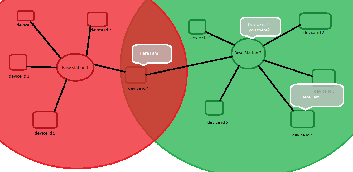

I am wanting to a wireless project and have been searching around for wireless transcievers with a range that will cover atleast 2km easily. Now thats when I tripped over the wireless section of the atmel website! While assessing the modules their, I have thought of something worth noting for this project;
my project involves an I2C bus with 7-bit addressing to communicate between all the devices, however I have come up with an issue. I can use up to 112 addresses to personalise each device which is fine for the average project, but my project requires 5 to 6 networks of 20 devices minimum which means there is not enough addresses. Thats were I wondering, do the Zigbee and Atmel wireless modules (ATZB-900-B0 is the one I'm looking at) use spread spectrum to reduce interference and allow two transmitters in the transcievers to operate at once? I'm thinking that this may be a way to solve my issue of addressing. Otherwise is there another way to over comne this problem without using 10-bit addressing (ie. some way of software addressing)?

Thanks 3v0, I'd rather a star topology in the sense that each device will communicate back to a base station, this allows me to have one device to control the whole network.
So what I am trying fix is represented in the pictures.
In the first one, you could say that
1. the two networks are running on different channels so the devices don't get confused
2. or there is a way to get more id's/addresses with I2C so I don't have to repeat some due to running out of them.
The second image shows what the network looks like when the cross over.
I hope this isn't too confusing
James

Zigbee/MiWi can be setup as a star topology. The network coordinator is at the center. But that may limit you to 7 address bits. Not sure you can check the datasheet I linked to the previous post. You really need to study this as it is much more complex then I2C SPI etc !
PAN: Personal Area network
PAN Coordinator: Node that manages the network. In the case of a star network it is the hub. Limited to 127 connections.
Coordinator: Node that is allowed to have 127 additional connections.
I think you want one PAN coordinator with 20 coordinators in a star. Each of the 20 coordinators acting as a star subnet with up to 127 additional nodes. In you second diagram each of the node 4's would share the high order address bits of its coordinator so there would be no conflict.
I am not sure where I2C comes into this. I suppose if you have a uC with I2C you could send it a radio packet with and I2C address and data. Not sure what the point of talking about I2C is in this context.

I realise that I have not really thought of this network too much in depth and so I have not explained myself very clearly. In the pictures the black lines represent the way the network traffic will follow using addressing.
Each device will receive all the data that is transmitted but it is the device that is addressed that will pay attention to the instructions or contents of the data.
So from the 'wireless hardware' point of view I guess you could say that it will be like point-to-mulitpoint or similar to the mesh, so that each device can contact each other, however, the network traffic will be set up to be like a star network where all the devices will have to talk to a base station to talk to something else.
