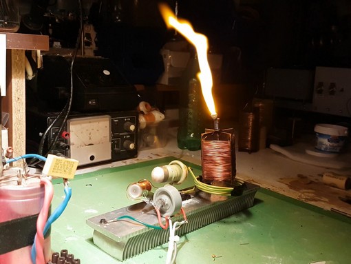

So I am making a simple ZVS circuit and I think I understand how it works, but I have a few questions such as, what purpose does the inductor play in this circuit? Are the zener diodes necessary or can they be replaced with normal fast switching diodes? Lastly is there a way to slowly (turn on the driver) so it doesn't consume so much current at turn on putting the circuit in danger?
Thank you,
Ben
The zeners need to be zeners. They are there to prevent the gate-source voltage from getting high enough to kill the mosfets.
Basically that general design that people keep replicating is just a really nasty circuit. It's only positive point is that it is simple.
At each half cycle of the oscillation, both FETs are turned on for a short time, creating a current spike.
And inductor can be thought of as a bit like a flywheel for current, it cannot change quickly so the momentary near-short-circuit does not destroy the transistors.
That use is what I'd class as a "Commutation choke".
You cannot turn it on slowly, as both transistors will start to turn on from the bias supply and may cook themselves before it starts to oscillate; the sudden turn-on and fractional imbalances in the circuit are what start the oscillator.
A separate non-overlap gate drive oscillator would solve many problems, but it adds the problem that it must be separately tuned to the resonant frequency of the power coil and ideally track that, so the overall circuit become a lot more complex.

Ok thanks. Here a screenshot it’s sitting right above the mosfet

I think it is an insulator. I read that in comment section at YT if i am remember corectly

I reckon that ceramic ite you circles is some kind of high voltage capacitor, by the way - it appears to have a metallised surface plus an internal connection?
