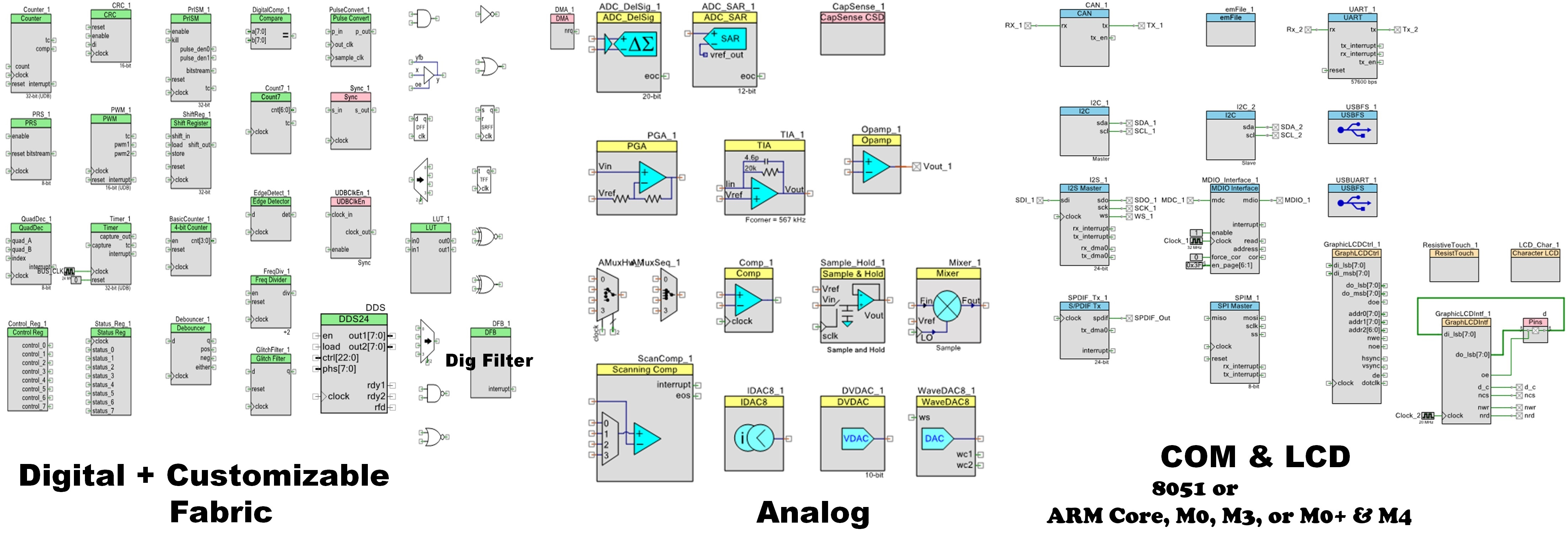

This is going to sound easy because it is.
There is a group of part families that has not only standard HW but also
a fabric for more sophisticated "standard" HW and user designed HW
if you want your own custom component.
So easy path first, you drag and drop out of parts HW library various HW
pieces, anything from simple gates to dig filter and in between, like PWM's
with deadband, up/dwn counters, timer..... Then using a simple wire wizard tool
wire uop internally and out to pins the HW components. Note each of the
pics below of the HW is an internal component. Then dbl click component
and config its basic parameters. Last you write 1 line of code, a start f()
given to you as a part of each components SW lib, and you have an almost
codeless design running. Tool does all the timing verification for you, its rare
you have to do anything with that. I have worked with that twices in 12 years,
rare you have to mess with it. Also not below all the analog HW in chip.
For designs that need real time control of the component HW, each component
has a rich lib of f() calls to manipulate it, like change PWM duty cycle, read
a counter, etc.. You are not writing drivers per se, just high level application
code, like what do I do with my A/D or counter value.
3 families, 4M low end, 5LP high end, 6 dual core for blue tooth and cryoto work.

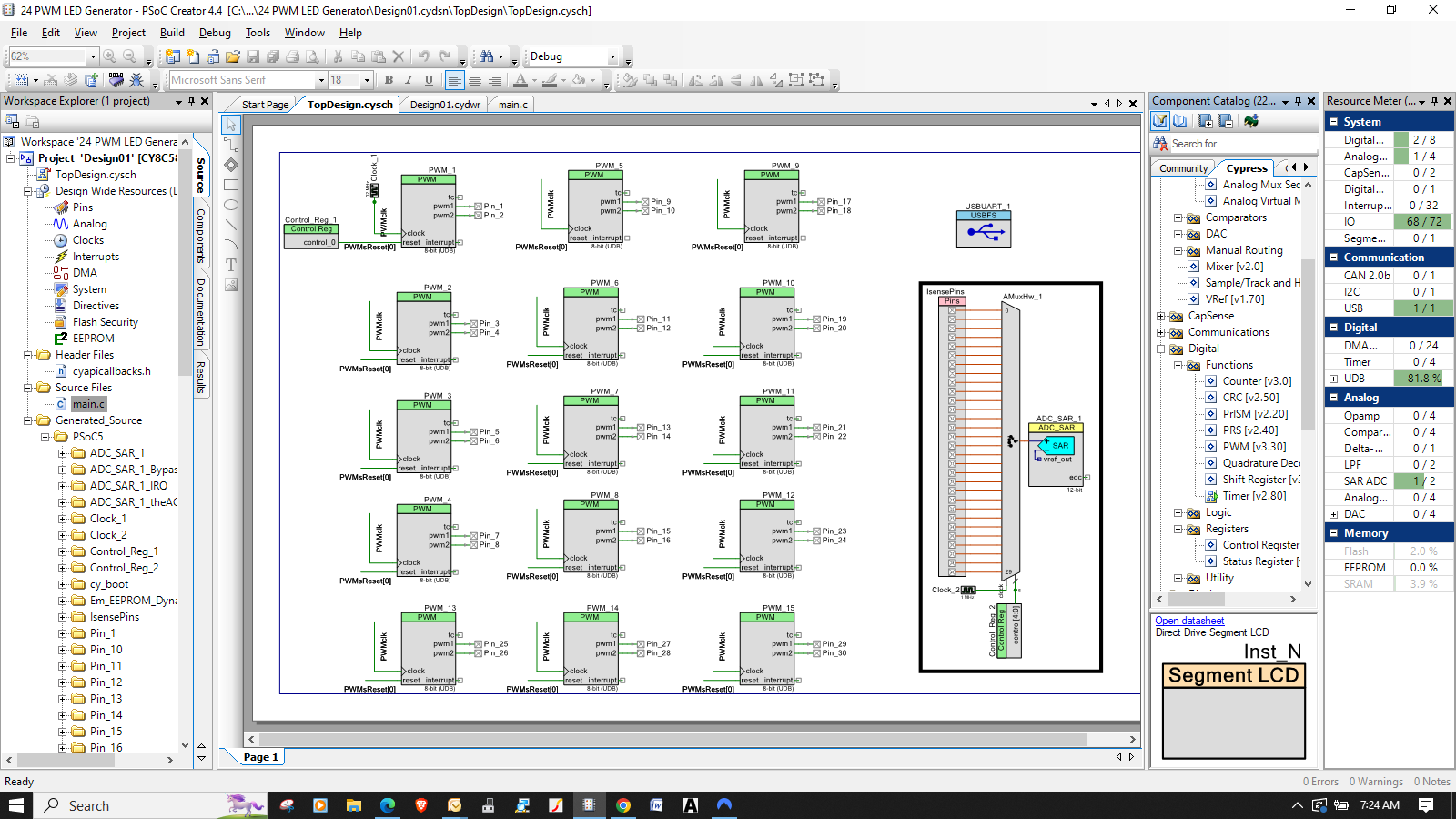

Here is specific example for recent design requirement, user needed 24 PWMs to drive
24 high power LEDs, to monitor each LEDs current. And to communicate to PC over
USBUART. This left a large amount of fabric and HW for other stuff available, like
display, encoder....One chip....
For more sophisticated users (the community) one can design their own onchip
component to add to the libs. User community has done CPLD, 74HC equivalents,
DDS.... I did a 64 bit SIPO shifter, 64 bit counter for proof of concept. Onchip compo-
nents can be done with schematic capture and or Verilog.

Here is one approach, minimal resources, first pass. Or you could use
a separate counter for each group, hours, mins, secs. Its your call.
Synth components ? Not sure what you mean, but solution is one chip.
Note how many resources still available for other stuff, right hand column.

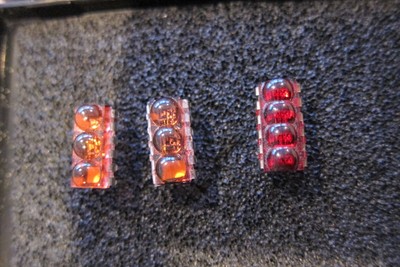

Did you see the mechanical 7 digit displays people 3D print. There was also a marble clock. Of course complicated 3D printed parts are not scalable enough to fit inside a wristwatch. At least with FDM 3D printing, the resolution is not great. I wish there was some small VFD displays for sale. There seems to be some new/old stock for sale but they are rather large. I know some calculators have small VFDs in them but again even those are quite long. Found this on Ebay.
Looking at Ebay wow there are a lot of VFDs and Nixie tubes for sale and they are not even that expensive. There is even a cylindrical VFD.
Imagine going through an airport with something like this on your arm lol:
If there was a way to have a display like this in a small package it would be the coolest thing ever. I wonder if something similar can be created with those filament like LEDs.
Smalles filament LED seems like 1.2cm. But they are quite thick. Maybe they can be put in a grid like that VFD. Maybe it would be possible to stack them like this to create something similar with that VDF. On a large scale it would be also possible to create the numbers by bending these.
