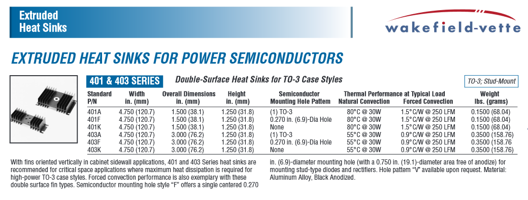

There is stacks of data on the net and elsewhere about heatsinks and also about making heatsinks
Heat-sinks are specified by their thermal resistance in deg/CW, to free air This is a measurement of how much heat the heatsink can dissipate into the air A small heatsink would typically be 10 deg/CW and a large one 0.5 deg/C W
http://www.wakefield-vette.com/resource-center/downloads/brochures/extruded-heat-sink-wakefield.pdf

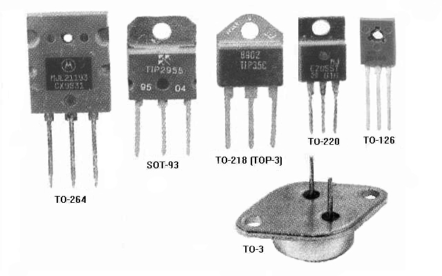

A typical thermal resistances from junction to case for a high power TO-3 transistor, is around 0.8 deg C W and, using a mica washer between the case and heatsink, the thermal resistance between the case and heatsink is 1.1 deg C W.

eto_2015_12_16_power_transistor_cases-jpg.96144
