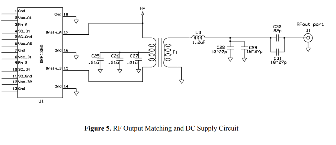

Why would they have removed the tank circuit and the isolating capacitors upstream of the toroidal inductor in this schematic? Also its not clear where the DC VDD now comes in?
It uses a direct push-pull drive to the centre tapped transformer primary, rather than the chokes as a DC path.
The "HV" point at the transformer centre tap is the main power in - up to 250V with that design.
The filtering and matching are done by the LC network after the transformer.

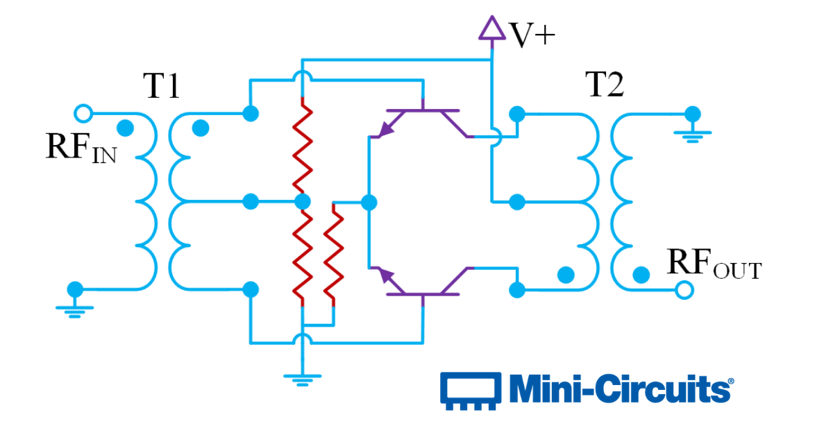

If you are interested in a more general approach and how/why things are designed as such, I'd suggest you look at some Ham Radio HF (short wave) power amp designs.
Some examples:

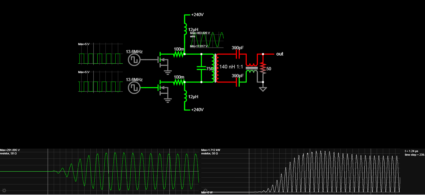

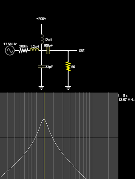

The IEEE link is preferable as a Current Mode Class D over the Microsemi design of VMCD with lower efficiency. It has stated the advantage of meeting both zero voltage switching (ZVS) and zero current switching (ZCS) conditions by proper design of the load network.
They don't specify the inductance of L coming from the HV source.
The Microsemi output filter assuming 1.2uF meant 1.2uH and the HV choke is at least 10x the resonant L.
The CMCD output filter using a rough simulation using Falstad below.
