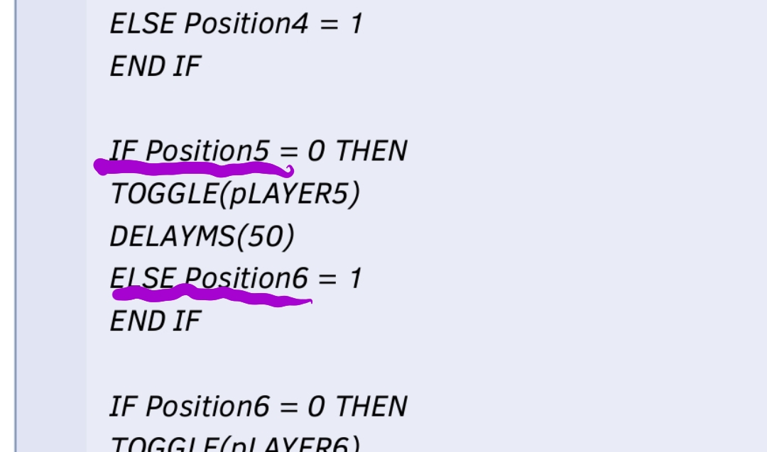

Well here is the whole enchilada at this point in time. The code is supposed to just monitor the battery condition but when the battery voltage goes down to 3.1 the yellow LOW Battery led comes on BUT portc.6 & 7 decide to come on as well.
Seriously thinking of eliminating the HLVD section but portc has no connections to portc ??

basic code

IF Position1 = 0 THEN
TOGGLE(pLAYER1)
DELAYMS(50)
ELSE Position1 = 1
END IF
IF Position2 = 0 THEN
TOGGLE(pLAYER2)
DELAYMS(50)
ELSE Position2 = 1
END IF
IF Position3 = 0 THEN
TOGGLE(pLAYER3)
DELAYMS(50)
ELSE Position3 = 1
END IF
IF Position4 = 0 THEN
TOGGLE(pLAYER4)
DELAYMS(50)
ELSE Position4 = 1
END IF
IF Position5 = 0 THEN
TOGGLE(pLAYER5)
DELAYMS(50)
ELSE Position6 = 1
END IF
IF Position6 = 0 THEN
TOGGLE(pLAYER6)
DELAYMS(50)
ELSE Position6 = 1
END IF
IF Position7 = 0 THEN
TOGGLE(pLAYER7)
DELAYMS(50)
ELSE Position7 = 1
END IF
IF Position8 = 0 THEN
TOGGLE(pLAYER8)
DELAYMS(50)
ELSE Position8 = 1
END IF
IF Position9 = 0 THEN
TOGGLE(pLAYER9)
DELAYMS(50)
ELSE Position9 = 1
END IF
IF Position10 = 0 THEN
TOGGLE(pLAYER10)
DELAYMS(50)
ELSE Position10 = 1
END IF

Isn't the else statement saying IF pin.x=1 then pin.x=1 - Looks kinda redundant. However, who knows how the hardware is wired.

You can't write to an input pin
Time1=1
Time2=1
Time3=1
Time4=1
       TOGGLE(pLAYER1)
       DELAYMS(50)
   ELSE                                 // you can only get here if Position1 = 1 already, so there's no point in this ELSE code
       Position1 = 1                // anyway, YOU CAN'T WRITE TO AN INPUT PIN
Do you see a pattern? What do you expect to happen when you write to a pin that's set as an input?
It's nice after all this you're not even using the INTOSC.BAS module!
By the way, 'CLOCK=20' is invalid for the internal osc... intosc.bas would have told you this had you used it
Try and think of a input pin being a read pin and a output pin being a write pin. Great mouse trap BTW, i guess it took a while to slip in seeing as you declared to not only have made it better but it was working.

Jon found a typing error in post #50
as for writing to an input I am in error but then I am aware of what the pin is supposed to be. Will take the errors out.
Not using it?? INTOSC.BAS module! after I inserted it into the code the timing work great. Just need to adjust the button debounce as the Leds start blinking when pressing desired button
I will add explanations to each line of code. As for the ELSE statement in # 50, have seen this in lots of code examples. not really needed but.
