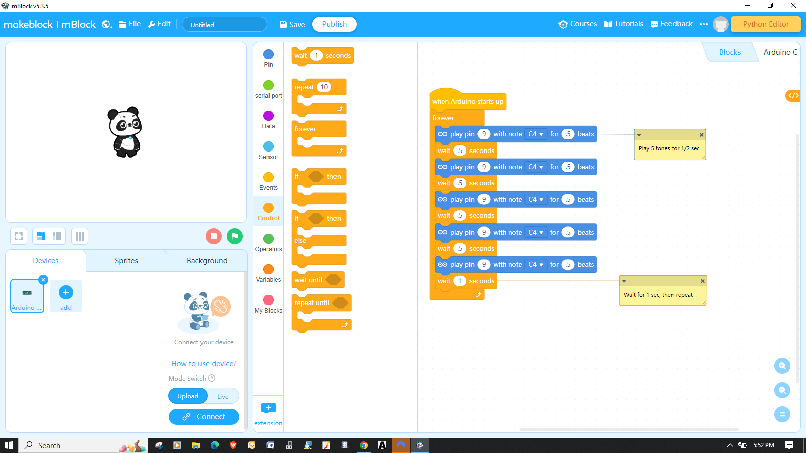

A quick and dirty, accurate (tone pitch, delays) use an Arduino, like a
nano board, and mBlock :
mBlock takes your block configuration, and converts this to Arduino code. The above
example should work. Use a Nano board (~$3) to develop, and then use the Nano board

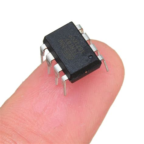

to program a ATTINY85 (8 pin dip) if you want a smaller solution size wise. 1 chip does the
solution.
To code you drag and drop blocks out of its library (2'ond window) into 3'rd window and config
the blocks.
I believe the above example should work. You can easily make more or less notes, even
do a musical jingle.....
Here is an example for a sophisticated sequence timer/pulse generator (just an example of
how capable and simple block programming can be) :

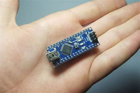

Nano board :
Attiny85 :
External you still need the buzzer/piezo.
The ATTINY85 runs from 2V to 5V, pretty low power.
The board is easiest to use as its USB to PC to program by mBlock.
To program the ATTINY85 you need a programmer, and there is
a program firmware in Arduino you can put in Nano board and use
it as programmer.

The Nano though small requiires more space than is available. 4 beeps would be fine. could you give me an example of what that circuit would look like using logic chips.

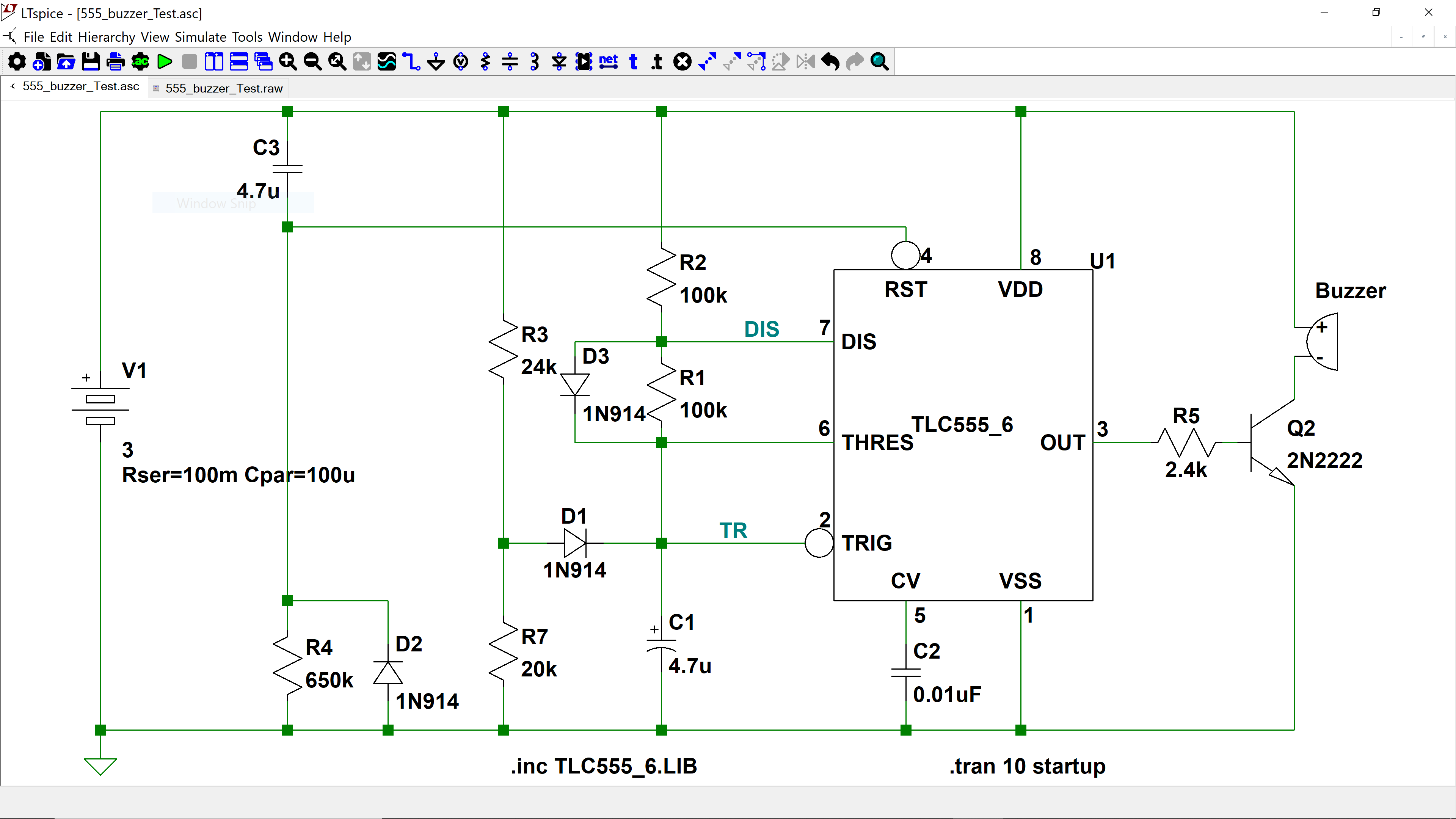

Here is a TLC555 version.
TLC555 astable clocks the buzzer until reset (when C3 is charged past the threshold of ~1v).
Assuming a 3v DC buzzer that draws more than 1ma.
Freq=1hz@50%.
D1 precharges C1.
Buzzes 5 times after power on (adjusts by C3/R4).
Not tested on hardware.

If you don't have room for an Arduino nano, other, smaller Arduino IDE programmable options exist. Also, an array of logic gates, 555 timers and associated caps and resistors will require as much or even more space.
The smaller Arduino options require a usb to serial UART adapter so it doesn't have to be on the Arduino board.
