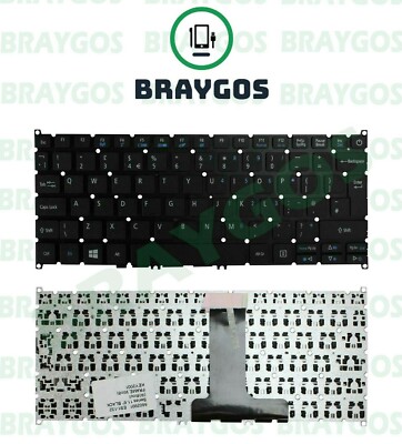

Contact switch failures in laptops do occur due to the membrane design. Using a USB keyboard can be used to compare the results. I'd see like to see the software issues in the NFO file.
As others have mentioned - try it with a USB keyboard.
If that works correctly you can be 99% sure the machine keyboard needs replacing. They are usually just a membrane key matrix, with the electronics built in to the machine motherboard, so a new keyboard is purely replacing the switch contacts and not any electronics.
A complete new keyboard for an ES11 appears to be £13.49 on ebay UK, if those are the correct ones.
Edit - apparently the machine full model is ES1-131 or ES1-132?
Keyboards for that are a bit more expensive, ~£17 whether ebay or Amazon;
