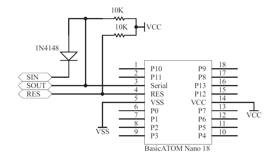

OK, we're trying to reverse engineer an expensive lead, to see if we can make a cheaper version. The lead consists of a (fully moulded) FTDI USB plug, which goes to a 'Y' shaped moulded plastic junction 'box', then two leads out to four pin mil. spec. plugs. One of the plugs is male, one is female, and connects to a logger and an optional external battery pack. So you unplug the external battery pack, plug it in to the relevant lead, and then connect the other plug to the logger. The two plugs are simply wired A to A, B to B, etc.
OK, so C is ground, D is presumably power from the battery (but I don't have an external battery pack to test), A is RTS, and B is bi-directional serial data on one pin.
If you plug just the USB plug in, with a terminal program it will echo any keys pressed back to the terminal program.
Without the logger plugged in, pin B is normally high, as soon as the logger is plugged in, it's pulled down low.
It's all run via a custom PC program, and can download all the settings and data from the logger, and upload new settings etc.
So has anyone got any suggestions as how to make the input/output as an FTDI chip work over a single pin? - bearing in mind I've no access to test anything, other than from the USB plug itself, and the two mil. spec. connectors. The lead is far too expensive to destroy, which is what I'd like to do, to examine it more closely.
I've built a 'break out' board, so I can take scope readings etc. and disconnect any of the lines I wish, and I did try adding a schottky diode in the serial connection, but either way round it stops communication taking place.

With a compliant RS-232 interface there is no way to implement a legitimate bi-directional data line. The "cheating" way to do it is with an open collector transceiver. The pullup to a voltage level greater than +3V is a compliant RS-232 level. The active pull down to "near ground" is not compliant but may work in many circumstances. To be compliant it would have to be at a voltage that is less than -3V.
Sounds like a typical "collision" bus communication design. This is very similar to the CI-V bus used in Icom radios (Amateur Radio). Multiple devices can communicate at any time, but each device has to check for "collisions" before transmitting. Once transmitting, a specific device has "control" until they are finished transmitting. On receive, all devices see the same data, and the protocol determines which device will act on the received data.
This type of communication bus usually has a small pull-up on each device, and input (receive) is high impedance. To transmit, they all use some form of open collector to draw the voltage down to initiate the data flow. Transmit should not start unless the data line is high for a determines number of "bits" or milliseconds.

A pull-up resistor and an open-collector output to pull low from the TX line.

Here is another image of a dual serial to a single serial interface used in the older BasicAtom processors: (works with TTL levels). Ignore the RES(reset line).
Nice, I feel embarrassed now that I was thinking of taking the Icom circuit above, and adding extra transistors to invert the the data :D
If I get time tomorrow at work, I'll wire an FTDI module like that, and see if it works :D
