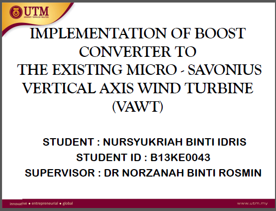

Boost 150mV to 1.5V
An alternator is an electrical generator that converts mechanical energy to electrical energy in the form of alternating current (AC) right? But, in my project, the output from the wind turbine was Direct Current (DC).
How can I use an alternator?

We explained that you cannot boost 0.15V/30mA to 1.5V/300mA to light an incandescent light bulb. If you boost the voltage 10 times then your current will decrease 10 times to only 3mA minus losses, then what will you use the 1.5V/3mA for?
I think you need to drop back and make some aerodynamic calculations on the turbine. Given the stated airflow, how much power can you theoretically get from the turbine?
You absolutely can not exceed this power output, but in reality, it's worse than that.
You need to consider the efficiency of converting this mechanical energy to electrical energy. This is where you evaluate permanent-magnet motors verses a purpose-built generator verses an alternator. The output power from this conversion will be less than the mechanical power generated by the turbine. This is called efficiency and it CAN NOT exceed a factor of 1.
Only after this point can you consider the conversion of electrical energy to a useful form. Again, you need to consider the efficiency of this step, and again, the efficiency WILL BE LESS THAN 100%. There are losses in each conversion, and it's not possible to get more power out than power in. All you can do is maximize the efficiency at each step of the conversion process.
I think I just outlined your project for you...at least what it needs to be even if it's not what you want it to be.

I think we've missed a key point here. If a permanent-magnet motor is rotating at its rated speed, the output voltage should be nearly its rated voltage (i.e., a motor rated at 6000 rpm with a 3 volt supply will generate nearly 3 volts when spun at 6000 rpm).
Since the motor/generator is only producing 0.15v, it must be running far below its rated speed. I suppose the motor is being driven directly by the turbine rotor at slow speed, so the output voltage is low.
The turbine may be capable of delivering much more power than is being delivered right now, but not at an optimal speed for the motor.
This gets back to those aerodynamic calculations. How much power can the turbine deliver at what speed ? How efficiently can the motor convert energy at that speed? Some kind of a speed increaser (think pulleys and a rubber band) may save the day.
A quick&dirty test would be to measure the speed of the turbine open circuit and again with the motor leads shorted together. If the turbine speed is virtually identical, the motor isn't generating anywhere near the power the turbine is capable of producing.

This thread actually illustrates a common problem. Both the original poster and almost everyone who has replied fell into this trap - starting with a solution before the problem is understood and defined.
The first problem is to determine how much power the turbine can produce at what speed. Only then should the conversion from mechanical to electrical energy be considered. What devices are available and at what speed are they most efficient. With a micro-power turbine, efficiency is the #1 priority.
Everyone who replied fell into the trap of providing a solution without unserstanding the problem. Why is the motor-turned-generator only putting out 0.15 volts (or is it a tenth of that?)? Have you ever seen a DC motor designed to run at 0.15 volts? That should have been a big red flag addressed before any soluion or lack of solution was offered.

He took the very low power wind turbine designed by somebody else and decided to "boost" its output power 100 times without understanding that energy cannot be increased.
Knowing that the output from the wind turbine generator was very low power he selected a much higher power incandescent light bulb as its load instead of selecting something that uses the low power properly.
Actually, if you look at the link provided earlier, you will see that "he" is actually a "she".
The word BINTI gives the game away. If my knowledge of Malay is up to scratch it means "daughter of", whereas BIN means "son of".
I would notice the girl if she walked past me but I did not notice her avatar.
It seems she has no clue about power or boosting power. She selected a micro wind turbine, designed a converter with an output of 1.25V and 250mA without noticing how much input current it needed. Then she selected a 1/2W load.

The project is flawed starting with the low output voltage of the generator. The turbine speed is too slow to turn the motor at a high enough speed to produce useful power.
If this project is to be useful, the speed the motor is turning at has to be increased. That is a given no matter how much you want to argue about it.
Is the turbine capable of producing more output power? At this point we know nothing about this. I described a simple measurement to take to get a feel for this already. Measure the turbine speed with no load. Then measure the turbine speed with the motor shorted - the max possible load under the present arrangement. If the speed doesn't change much, the turbine isn't delivering much power to the motor because of how slowly it's turning.
