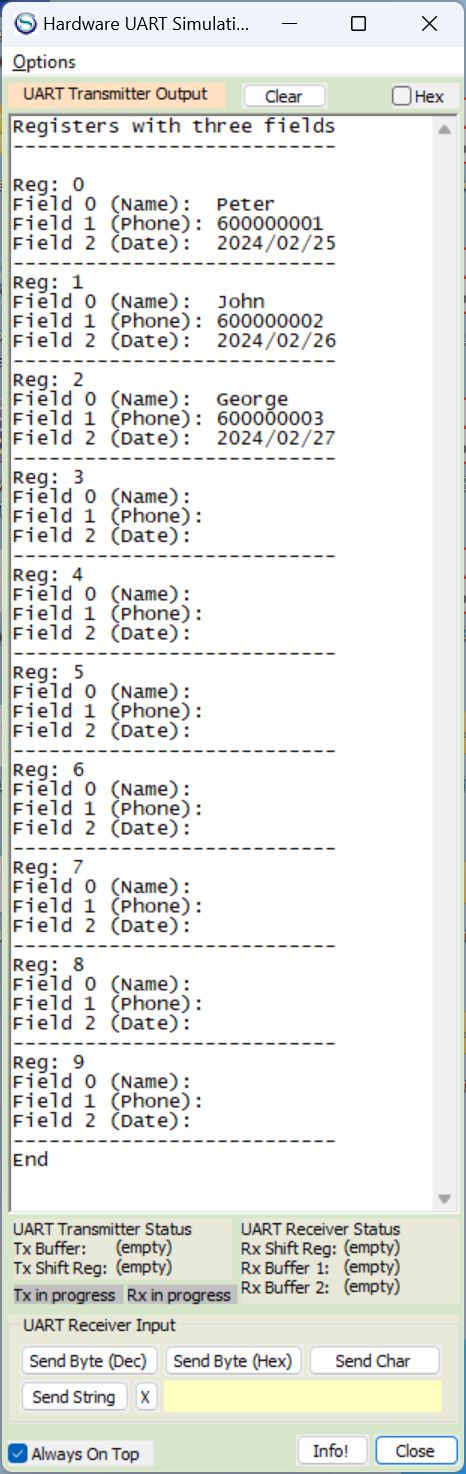

UART_Write "Registers with three fields", CrLf
UART_Write "---------------------------", CrLf, CrLf
'Extract field (read registers).
For x = 0 To 9 'Registers
UART_Write "Reg: ",#x, CrLf
_String = Read_List(Name, x, P_List)
UART_Write "Field 0 (Name): ", _String, CrLf
_String = Read_List(Phone, x, P_List)
UART_Write "Field 1 (Phone): ", _String, CrLf
_String = Read_List(Date, x, P_List)
UART_Write "Field 2 (Date): ", _String, CrLf
Next x
UART_Write "End", CrLf

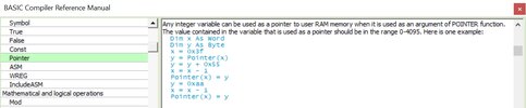

Proc _Pointer0(ByRef _p As Word)
Symbol _Return_HB = _p.HB
Symbol _Return_LB = _p.LB
ASM: LFSR 2, _p0
ASM: MOVFW FSR2H
ASM: MOVWF _Return_HB
ASM: MOVFW FSR2L
ASM: MOVWF _Return_LB
End Proc

'Calculates the address of the first element of the field.
p_array = field + (register * (FieldLength * nFields)) + (field * (FieldLength -1)) + p_array
For index = 0 To (FieldLength -1) 'Traverse the field using the index "x".
If string_input(x) = 0 Then flag = 1 'End of field mark
If flag = 0 Then
Pointer(index + p_array) = string_input(index) 'Write a copy in the indicated register field.
Else
Pointer(index + p_array) = 0 'Remove any unused characters from the field.
Endif
Next index
End Function

Regarding POINTER, this is now in Oshonsoft:
C
Pointer has been in the language for several years. The argument or value of pointer is a memory address, and this memory address belongs to a variable or a register of the microcontroller. The problem with pointer is that it has to be accompanied by a way to assign memory addresses at runtime, and it is something that the system currently does not have, so the true power of Pointer is wasted. I have asked an AI to expand the explanation of pointer in the manual, I attach the extension:
A pointer is a variable that stores the memory address of another variable. In the context of the programming language you are using, any integer variable can act as a pointer when used as an argument of the POINTER function. The POINTER function takes the value stored in the variable "x" as the memory address and returns the value stored at that memory location.
It is important to note that the value contained in the variable used as a pointer must be within the range of 0 to 4095, which is the range of RAM memory addresses available to the user in this system.
Here's an example to illustrate how a pointer is used:

During the simulation it is hypnotic to see how the data from the records move through the vector.
