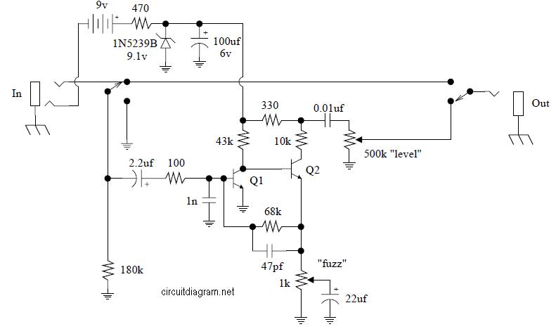

Schematic, for reference:

One of the articles on the JH-2 says to just put a pair of BC109 transistors in it.. They are a common silicon type from a few years ago.

That JH-2 in your picture is not original - has been modified with extra controls and the pcb is from something else (possibly another model) - it's using 2SB175's which are still Germanium and were used for a short while (I think it was possibly in the 90's) before reverting back to BC109's.
Also that schematic further back is not correct for the JH-2.
Note that you can't just drop BC109's in, the original JH-2 used the germanium PNP transistors and the BC109's are NPN type.
